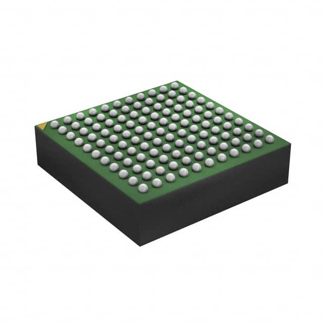

Datasheet Linear Technology LTM8056 — Даташит
Производитель | Linear Technology |
Серия | LTM8056 |
58VIN, 48VOUT Buck-Boost µModule (Power Module) Regulator
LTM8056 - 58VIN, 48VOUT Buck-Boost µModule Regulator

LTM8056EY#PBF | LTM8056IY | LTM8056IY#PBF | LTM8056MPY | LTM8056MPY#PBF | |
N | 1 | 2 | 3 | 4 | 5 |
Корпус | 15mm x 15mm x 4.92mm BGA Габаритный чертеж корпуса | 15mm x 15mm x 4.92mm BGA Габаритный чертеж корпуса | 15mm x 15mm x 4.92mm BGA Габаритный чертеж корпуса | 15mm x 15mm x 4.92mm BGA Габаритный чертеж корпуса | 15mm x 15mm x 4.92mm BGA Габаритный чертеж корпуса |
Код корпуса | BGA | BGA | BGA | BGA | BGA |
Индекс корпуса | 05-08-1891 | 05-08-1891 | 05-08-1891 | 05-08-1891 | 05-08-1891 |
Количество выводов | 121 | 121 | 121 | 121 | 121 |
Parameters / Models | LTM8056EY#PBF | LTM8056IY | LTM8056IY#PBF | LTM8056MPY | LTM8056MPY#PBF |
Demo Boards | DC2154A | DC2154A | DC2154A | DC2154A | DC2154A |
Design Tools | LTspice File,LTpowerCAD File | LTspice File,LTpowerCAD File | LTspice File,LTpowerCAD File | LTspice File,LTpowerCAD File | LTspice File,LTpowerCAD File |
Экспортный контроль | нет | нет | нет | нет | нет |
Основные особенности | Programmable Input Current Limit, Programmable Output Current Limit, Input Current Monitor, Output Current Monitor, PolyPhase, Resistor Set Frequency, External Synchronization | Programmable Input Current Limit, Programmable Output Current Limit, Input Current Monitor, Output Current Monitor, PolyPhase, Resistor Set Frequency, External Synchronization | Programmable Input Current Limit, Programmable Output Current Limit, Input Current Monitor, Output Current Monitor, PolyPhase, Resistor Set Frequency, External Synchronization | Programmable Input Current Limit, Programmable Output Current Limit, Input Current Monitor, Output Current Monitor, PolyPhase, Resistor Set Frequency, External Synchronization | Programmable Input Current Limit, Programmable Output Current Limit, Input Current Monitor, Output Current Monitor, PolyPhase, Resistor Set Frequency, External Synchronization |
Float Voltage, В | Up to 48V | Up to 48V | Up to 48V | Up to 48V | Up to 48V |
Max Charge Current, A | 5.4 | 5.4 | 5.4 | 5.4 | 5.4 |
Number of Cells | Up to 48V float voltage | Up to 48V float voltage | Up to 48V float voltage | Up to 48V float voltage | Up to 48V float voltage |
Рабочий диапазон температур, °C | от 0 до 85 | от -40 до 85 | от -40 до 85 | от -55 до 125 | от -55 до 125 |
Type of Charger | Switching | Switching | Switching | Switching | Switching |
Vin Max, В | 58 | 58 | 58 | 58 | 58 |
Vin Min, В | 5 | 5 | 5 | 5 | 5 |
