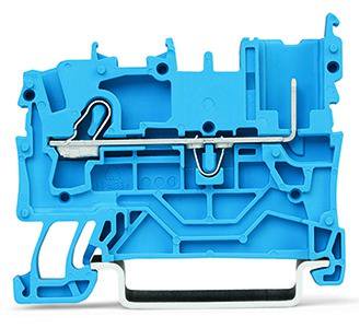

Datasheet Wago 2022-1204 — Даташит
1-conductor/1-pin carrier terminal block; for DIN-rail 35 x 15 and 35 x 7.5; 2.5 mm²; Push-in CAGE CLAMP

Actuation type | Operating tool Push-in |
Цвет | blue |
Connectable conductor materials | Copper |
Connection technology | Push-in CAGE CLAMP® |
Country of origin | CN |
Габариты: глубина | 48.5 mm / 1.909 inch |
Design | horizontal |
Fine-stranded conductor | 0.25 … 4 mm² / 22 … 12 AWG |
Fine-stranded conductor with ferrule, push-in termination, from | 0.75 mm² / 18 AWG |
Fire load | 0.112 MJ |
GTIN | 4050821145073 |
Height from upper-edge of DIN-35 rail | 32.5 mm / 1.28 inch |
Legend (ratings) | (III / 3) ≙ Overvoltage category III / Pollution degree 3 |
Marking level | Center/side marking |
Nominal cross section | 2.5 mm² |
Number of levels | 1 |
Product Group | 18 (X-COM-System) |
Rated current | 24 A |
Rated current (2) | 32 A |
Rated impulse voltage (III / 3) | 6 kV |
Rated voltage (III / 3) | 690 В |
Solid conductor | 0.25 … 4 mm² / 22 … 12 AWG |
Solid conductor, push-in termination | 0.75 … 4 mm² / 18 … 12 AWG |
Strip length | 10 … 12 mm / 0.39 … 0.47 Inch |
Total number of connection points | 1 |
Total number of potentials | 1 |
Type of mounting | DIN-35 rail |
Type of wiring | Front-entry wiring |
Вес | 5.038 г |
Ширина | 5.2 mm / 0.205 inch |
