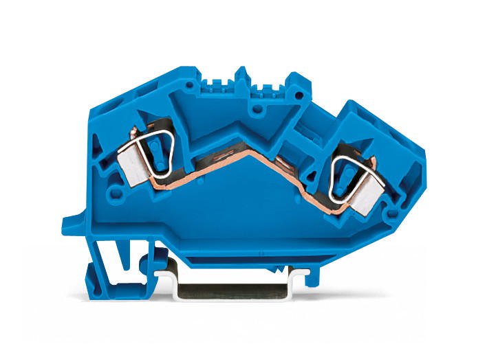

Parameters / Models | 782-300 | 782-317 | 782-321 | 782-601 | 782-604 | 782-607 | 782-607/999-950 | 782-623 | 782-992 |
Abmessungen B x H x T (inch), дюйм | (0.059 x 1.713 x 3.236) | ||||||||
Abmessungen B x H x T (mm), мм | (1.5 x 43.5 x 82.2) | ||||||||
Actuation type | Operating tool | Operating tool | Operating tool | Operating tool | Operating tool | Operating tool | |||
Цвет | orange | orange | blue | gray | blue | green-yellow | green-yellow | gray | light gray |
Connectable conductor materials | Copper | Copper | Copper | Copper | Copper | Copper | |||
Connection technology | CAGE CLAMP® | CAGE CLAMP® | CAGE CLAMP® | CAGE CLAMP® | CAGE CLAMP® | CAGE CLAMP® | |||
Country of origin | DE | CN | DE | DE | DE | DE | DE | PL | DE |
Габариты: глубина | 82.2 mm / 3.236 inch | 82.2 mm / 3.236 inch | 82.5 mm / 3.248 inch | 82.5 mm / 3.248 inch | 82.5 mm / 3.248 inch | 82.5 mm / 3.248 inch | 82.5 mm / 3.248 inch | 82.5 mm / 3.248 inch | |
Design | angled | angled | angled | angled | angled | angled | |||
Fine-stranded conductor | 0.2 … 6 mm² / 24 … 10 AWG | 0.2 … 6 mm² / 24 … 10 AWG | 0.2 … 6 mm² / 24 … 10 AWG | 0.2 … 6 mm² / 24 … 10 AWG | 0.2 … 6 mm² / 24 … 10 AWG | 0.2 … 6 mm² / 24 … 10 AWG | |||
Fire load, MJ | 0.013 | 0.124 | 0.163 | 0.306 | 0.306 | 0.303 | |||
GTIN | 4017332287548 | 4017332287555 | 4017332287562 | 4044918583305 | 4044918583343 | 4045454084721 | 4045454092702 | 4045454186913 | 4044918583404 |
Height | 43.5 mm / 1.713 inch | 43.5 mm / 1.713 inch | |||||||
Height from upper-edge of DIN-35 rail | 43.5 mm / 1.713 inch | 43.5 mm / 1.713 inch | 43.5 mm / 1.713 inch | 43.5 mm / 1.713 inch | 43.5 mm / 1.713 inch | 43.5 mm / 1.713 inch | |||
Insulating material | Polyamide 66 (PA 66) | Polyamide 66 (PA 66) | Polyamide 66 (PA 66) | Polyamide 66 (PA 66) | Polyamide 66 (PA 66) | ||||
Legend (ratings) | (III / 3) ≙ Overvoltage category III / Pollution degree 3 | (III / 3) ≙ Overvoltage category III / Pollution degree 3 | (III / 3) ≙ Overvoltage category III / Pollution degree 3 | ||||||
Main product function | Mounting Accessories | ||||||||
Marking level | Center marking | Center marking | Center marking | Center marking | Center marking | Center marking | |||
Number of levels | 1 | 1 | 1 | 1 | 1 | 1 | |||
Product Group | 17 (TOP JOB installation terminal blocks) | 17 (TOP JOB installation terminal blocks) | 17 (TOP JOB installation terminal blocks) | 17 (TOP JOB installation terminal blocks) | |||||
Rated current, A | 41 | 41 | 41 | ||||||
Rated impulse voltage (III / 3), kV | 8 | 8 | 6 | ||||||
Rated voltage (III / 3), В | 1000 | 1000 | 400 | ||||||
Rated voltage EN (Ex e II), В | 750 | ||||||||
Solid conductor | 0.2 … 6 mm² / 24 … 10 AWG | 0.2 … 6 mm² / 24 … 10 AWG | 0.2 … 6 mm² / 24 … 10 AWG | 0.2 … 6 mm² / 24 … 10 AWG | 0.2 … 6 mm² / 24 … 10 AWG | 0.2 … 6 mm² / 24 … 10 AWG | |||
Strip length | 12 … 13 mm / 0.47 … 0.51 Inch | 12 … 13 mm / 0.47 … 0.51 Inch | 12 … 13 mm / 0.47 … 0.51 Inch | 12 … 13 mm / 0.47 … 0.51 Inch | 12 … 13 mm / 0.47 … 0.51 Inch | 12 … 13 mm / 0.47 … 0.51 Inch | |||
Total number of connection points | 2 | 2 | 2 | 2 | 1 | 2 | |||
Total number of potentials | 1 | 1 | 1 | 1 | 1 | 1 | |||
Type of mounting | DIN-35 rail | DIN-35 rail | DIN-35 rail | DIN-35 rail | DIN-35 rail | DIN-35 rail | |||
Type of wiring | Front-entry wiring | Front-entry wiring | Front-entry wiring | Front-entry wiring | Front-entry wiring | Front-entry wiring | |||
Вес, г | 0.421 | 4.125 | 5.42 | 17.076 | 16.972 | 25.66 | 26.2 | 25.195 | 16.966 |
Ширина | 1.5 mm / 0.059 inch | 1.5 mm / 0.059 inch | 8 mm / 0.315 inch | 8 mm / 0.315 inch | 8 mm / 0.315 inch | 8 mm / 0.315 inch | 8 mm / 0.315 inch | 8 mm / 0.315 inch |
