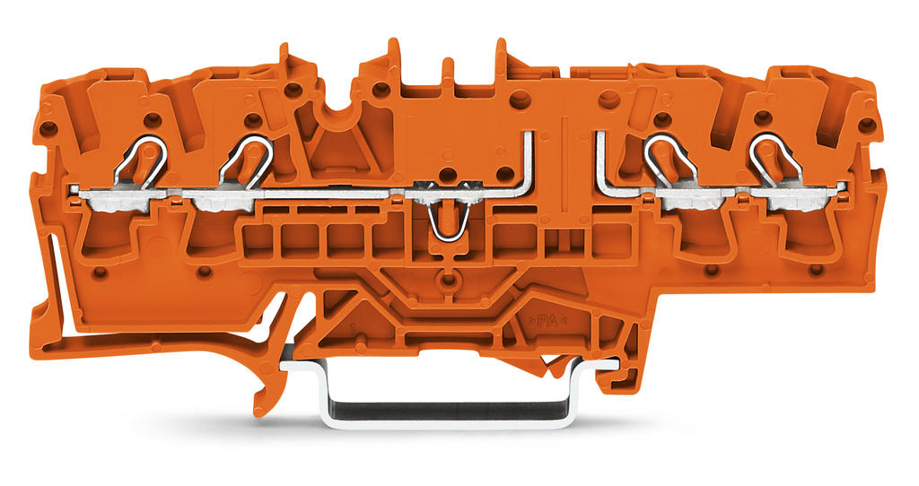

TOPJOB S feedthrough terminal block; same profile as other 2002-18xx terminal blocks; rail mount; 4-conductor; 5.2 mm wide; orange
Цены
Купить 2002-1802 на РадиоЛоцман.Цены — от 538 до 98 ₽ 4-пров. проходная клемма, 0,25 - 2,5 (4) мм2, with test option as 4-conductor disconnect tb, orange | |||
2002-1802 Wago Оф. дистрибьютор | 538 ₽ | ||
2002-1802 Wago | 1 888 ₽ | ||
2002-1802 Wago | 98 ₽ |
Actuation type | Open Tool Slot |
Цвет | orange |
Connectable conductor materials | Copper |
Connection technology | Push-in CAGE CLAMP® |
Country of origin | CN |
Габариты: глубина | 87.5 mm / 3.445 inch |
Design | horizontal |
Fine-stranded conductor | 0.25 … 4 mm² / 22 … 12 AWG |
Fine-stranded conductor with ferrule, push-in termination, from | 0.75 mm² / 18 AWG |
Fire load | 0.191 MJ |
GTIN | 4045454974688 |
Height from upper-edge of DIN-35 rail | 32.9 mm / 1.295 inch |
Legend (ratings) | (III / 3) ≙ Overvoltage category III / Pollution degree 3 |
Marking level | Center/side marking |
Nominal cross section | 2.5 mm² |
Number of levels | 1 |
Rated current | 16 A |
Rated impulse voltage (III / 3) | 6 kV |
Rated voltage (III / 3) | 400 В |
Solid conductor | 0.25 … 4 mm² / 22 … 12 AWG |
Solid conductor, push-in termination | 0.75 … 4 mm² / 18 … 12 AWG |
Strip length | 10 … 12 mm / 0.39 … 0.47 Inch |
Total number of connection points | 4 |
Total number of potentials | 1 |
Type of mounting | DIN-35 rail |
Type of wiring | Front-entry wiring |
Вес | 9.823 г |
Ширина | 5.2 mm / 0.205 inch |
