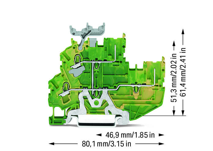

Actuation type | Operating tool Push-in |
Цвет | green-yellow |
Connectable conductor materials | Copper |
Connection technology | Push-in CAGE CLAMP® |
Country of origin | CN |
Габариты: глубина | 80.1 mm / 3.154 inch |
Design | horizontal |
Fine-stranded conductor | 0.25 … 4 mm² / 22 … 12 AWG |
Fine-stranded conductor with ferrule, push-in termination, from | 0.75 mm² / 18 AWG |
GTIN | 4055143527552 |
Height from upper-edge of DIN-35 rail | 61.4 mm / 2.417 inch |
Marking level | Side marking |
Nominal cross section | 2.5 mm² |
Number of levels | 2 |
Potential marking | PE |
Solid conductor | 0.25 … 4 mm² / 22 … 12 AWG |
Solid conductor, push-in termination | 0.75 … 4 mm² / 18 … 12 AWG |
Strip length | 10 … 12 mm / 0.39 … 0.47 Inch |
Total number of connection points | 2 |
Total number of potentials | 1 |
Type of mounting | DIN-35 rail |
Type of wiring | Front-entry wiring |
Вес | 16.298 г |
Ширина | 5.2 mm / 0.205 inch |
