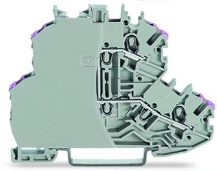

Datasheet Wago 2002-2208/099-000 — Даташит
TOPJOB S double-deck terminal block; internally commoned; with gray separator; rail mount; 4-conductor; 6.2 mm wide; gray

Actuation type | Open Tool Slot |
Цвет | gray |
Connectable conductor materials | Copper |
Connection technology | Push-in CAGE CLAMP® |
Country of origin | DE |
Габариты: глубина | 69.7 mm / 2.744 inch |
Design | horizontal |
Fine-stranded conductor | 0.25 … 4 mm² / 22 … 12 AWG |
Fine-stranded conductor with ferrule, push-in termination, from | 0.75 mm² / 18 AWG |
Fire load | 0.301 MJ |
GTIN | 4050821299035 |
Height from upper-edge of DIN-35 rail | 51.7 mm / 2.035 inch |
Legend (ratings) | (III / 3) ≙ Overvoltage category III / Pollution degree 3 |
Marking level | Center/side marking |
Nominal cross section | 2.5 mm² |
Number of levels | 2 |
Potential marking | L |
Rated current | 24 A |
Rated impulse voltage (III / 3) | 8 kV |
Rated voltage (III / 3) | 800 В |
Solid conductor | 0.25 … 4 mm² / 22 … 12 AWG |
Solid conductor, push-in termination | 0.75 … 4 mm² / 18 … 12 AWG |
Strip length | 10 … 12 mm / 0.39 … 0.47 Inch |
Total number of connection points | 4 |
Total number of potentials | 1 |
Type of mounting | DIN-35 rail |
Type of wiring | Front-entry wiring |
Вес | 13.766 г |
Ширина | 6.2 mm / 0.244 inch |
