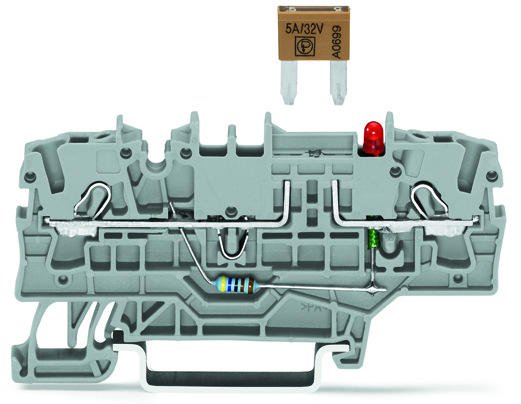

Datasheet Wago 2002-1981/1000-414 — Даташит
TOPJOB S fuse terminal block; mini-auto fuse; with blown fuse LED indication for 48 V (N-P); with additional jumper location; rail mount; 2-conductor; 5.2 mm wide; gray
Цены
Купить 2002-1981/1000-414 на РадиоЛоцман.Цены — от 1 159 до 403 ₽ 2-пр. держ. предохранителя, вилочн. (автомоб), индикатор | |||
2002-1981/1000-414 Wago Оф. дистрибьютор | 1 159 ₽ | ||
2002-1981/1000-414 Wago | 213 ₽ | ||
2002-1981/1000-414 Wago | 403 ₽ |
Actuation type | Open Tool Slot |
Цвет | gray |
Connectable conductor materials | Copper |
Connection technology | Push-in CAGE CLAMP® |
Country of origin | DE |
Габариты: глубина | 72.9 mm / 2.87 inch |
Design | horizontal |
Fine-stranded conductor | 0.25 … 4 mm² / 22 … 12 AWG |
Fine-stranded conductor with ferrule, push-in termination, from | 0.75 mm² / 18 AWG |
GTIN | 4050821089278 |
Height from upper-edge of DIN-35 rail | 32.9 mm / 1.295 inch |
Legend (ratings) | (III / 3) ≙ Overvoltage category III / Pollution degree 3 |
Marking level | Center/side marking |
Nominal cross section | 2.5 mm² |
Number of levels | 1 |
Product Group | 22 (TOPJOB S) |
Rated current | 10 A |
Rated impulse voltage (III / 3) | 6 kV |
Rated voltage (III / 3) | 400 В |
Solid conductor | 0.25 … 4 mm² / 22 … 12 AWG |
Solid conductor, push-in termination | 0.75 … 4 mm² / 18 … 12 AWG |
Strip length | 10 … 12 mm / 0.39 … 0.47 Inch |
Total number of connection points | 2 |
Total number of potentials | 2 |
Type of mounting | DIN-35 rail |
Type of wiring | Front-entry wiring |
Вес | 8.212 г |
Ширина | 5.2 mm / 0.205 inch |
