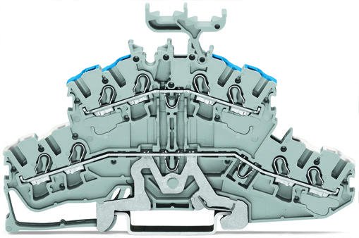

Datasheet Wago 2002-2428 — Даташит
Double-deck terminal block; ground/through (Shield/L); rail mount; 4-conductor; 5.2 mm wide; gray
Цены
2-уровн. клемма, 0,25 - 2,5 (4) мм2, 4-пров., серая, | |||
2002-2428 Wago Оф. дистрибьютор | 834 ₽ | ||
2002-2428 Wago | по запросу |
Actuation type | Open Tool Slot |
Цвет | gray |
Connectable conductor materials | Copper |
Connection technology | Push-in CAGE CLAMP® |
Country of origin | DE |
Габариты: глубина | 105.1 mm / 4.138 inch |
Design | horizontal |
Fine-stranded conductor | 0.25 … 4 mm² / 22 … 12 AWG |
Fine-stranded conductor with ferrule, push-in termination, from | 0.75 mm² / 18 AWG |
Fire load | 0.284 MJ |
GTIN | 4045454752439 |
Height from upper-edge of DIN-35 rail | 52.1 mm / 2.051 inch |
Legend (ratings) | (III / 3) ≙ Overvoltage category III / Pollution degree 3 |
Marking level | Center/side marking |
Nominal cross section | 2.5 mm² |
Number of connection points | 4 |
Number of connection points (connection type) | 4 |
Number of levels | 2 |
Potential marking | Schirm/L |
Product Group | 22 (TOPJOB S) |
Rated current | 24 A |
Rated current (2) | 28 A |
Rated impulse voltage (III / 3) | 8 kV |
Rated voltage (III / 3) | 800 В |
Solid conductor | 0.25 … 4 mm² / 22 … 12 AWG |
Solid conductor, push-in termination | 0.75 … 4 mm² / 18 … 12 AWG |
Strip length | 10 … 12 mm / 0.39 … 0.47 Inch |
Total number of connection points | 8 |
Total number of potentials | 2 |
Type of mounting | DIN-35 rail |
Type of wiring | Front-entry wiring |
Вес | 18.557 г |
Ширина | 5.2 mm / 0.205 inch |
