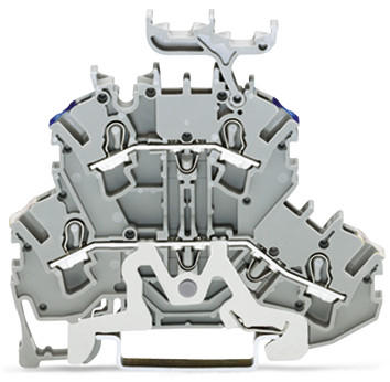

Double-deck terminal block; shield/through (Shield/N); with marker carrier; rail mount; 2-conductor; 5.2 mm wide; gray

Actuation typeOpen Tool Slot
Цветgray
Connectable conductor materialsCopper
Connection technologyPush-in CAGE CLAMP®
Country of originDE
Габариты: глубина69.7 mm / 2.744 inch
Designhorizontal
Fine-stranded conductor0.25 … 4 mm² / 22 … 12 AWG
Fine-stranded conductor with ferrule, push-in termination, from0.75 mm² / 18 AWG
Fire load0.212 MJ
GTIN4050821175179
Height from upper-edge of DIN-35 rail61.8 mm / 2.433 inch
Insulating materialPolyamide 66 (PA 66)
Legend (ratings)(III / 3) ≙ Overvoltage category III / Pollution degree 3
Marking levelCenter/side marking
Nominal cross section2.5 mm²
Number of connection points2
Number of connection points (connection type)2
Number of levels2
Potential markingSchirm//N
Product Group22 (TOPJOB S)
Rated current24 A
Rated current (2)28 A
Rated impulse voltage (III / 3)6 kV
Rated voltage (III / 3)500 В
Solid conductor0.25 … 4 mm² / 22 … 12 AWG
Solid conductor, push-in termination0.75 … 4 mm² / 18 … 12 AWG
Strip length10 … 12 mm / 0.39 … 0.47 Inch
Total number of connection points4
Total number of potentials2
Type of mountingDIN-35 rail
Type of wiringFront-entry wiring
Вес13.41 г
Ширина5.2 mm / 0.205 inch
