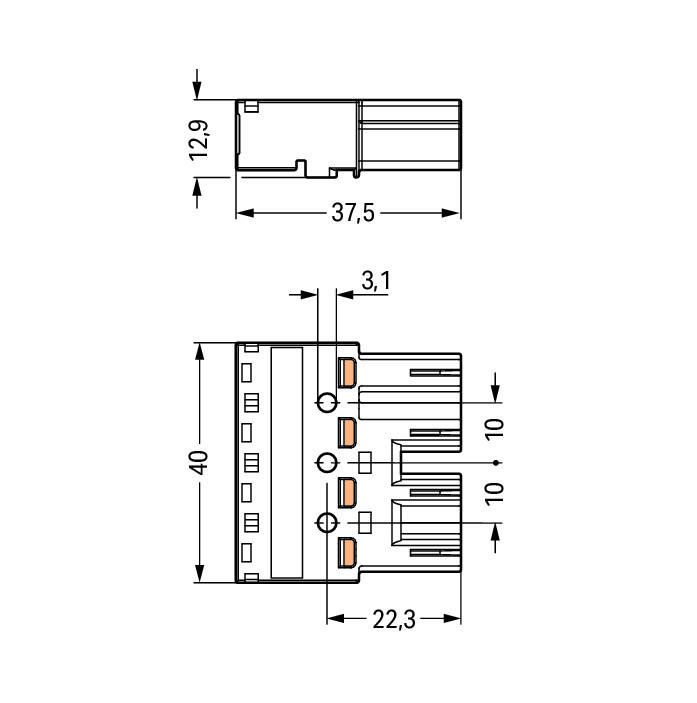

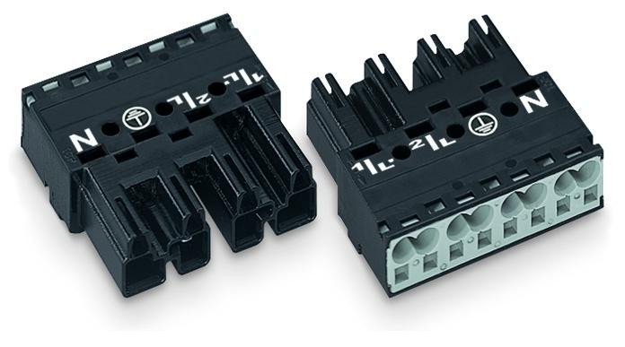

Actuation type | Operating tool Push-in |
Clamping spring material | Chrome nickel spring steel (CrNi) |
Coding | A |
Цвет | black |
Connection technology | Push-in CAGE CLAMP® |
Connector connection type | for conductors |
Contact material | Copper or copper alloy, surface-treated |
Contact type (pluggable connector) | Male connector/plug |
Country of origin | DE |
Degree of protection | IP20 |
Габариты: глубина | 37.5 mm / 1.476 inch |
Fine-stranded conductor | 0.5 … 4 mm² / 20 … 12 AWG |
Fine-stranded conductor with ferrule with plastic collar | 0.25 … 1.5 mm² / 20 … 16 AWG |
Fine-stranded conductor with ferrule without plastic collar | 0.25 … 2.5 mm² / 20 … 14 AWG |
Fine-stranded conductor with ferrule, push-in termination, from | 1.5 mm² / 16 AWG |
Fire load | 0.248 MJ |
GTIN | 4044918254519 |
Ground function | with preceding GND contact |
Height | 12.9 mm / 0.508 inch |
Legend (ratings) | (III / 3) ≙ Overvoltage category III / Pollution degree 3 |
Locking lever | нет |
Locking of plug-in connection | locking lever |
Marking | N ⏚ 2|L 1|L' |
Mating force of a plug-in connection | approx. 20 … 70 N (depending on pole number) |
Mismating protection | Yes |
Nominal cross section | 4 mm² |
Note (strip length) | see also packaging or instructions |
Number of Poles | 4 |
Pin spacing | 10 mm (0.394 inch) |
Potential marking | N ⏚ 2/L 1/L' |
Product Group | 20 (WINSTA) |
Rated current | 25 A |
Rated impulse voltage (III / 3) | 6 kV |
Rated voltage (III / 3) | 400 В |
Retention force of a plug-in connection | when locked: > 80N |
Solid conductor | 0.5 … 4 mm² / 20 … 12 AWG |
Solid conductor, push-in termination | 1.5 … 4 mm² / 16 … 12 AWG |
Stranded conductor | 0.5 … 2.5 mm² / 20 … 14 AWG |
Strip length | 9 mm / 0.35 Inch |
Surrounding air (operating) temperature | -35 … 85 °C |
Total number of connection points | 8 |
Total number of potentials | 4 |
Unmating force of a plug-in connection | when unlocked: approx. 20 … 70 N (depending on pole number) |
Вес | 12.858 г |
Ширина | 30 mm / 1.181 inch |
