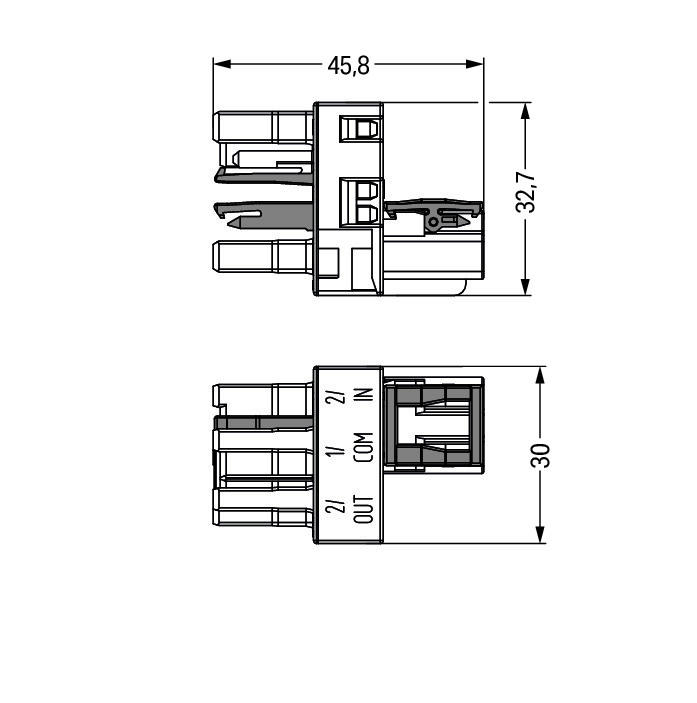

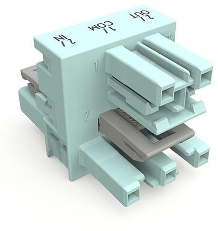

Код. B; 1 вход; 2 вывода
Цены
Distributor for status queries (25 шт) | |||
770-977/076-000 Wago | 149 ₽ |
Coding | B |
Connector connection type | for pluggable connectors |
Contact material | Copper or copper alloy, surface-treated |
Contact type (pluggable connector) | Socket/plug |
Country of origin | DE |
Degree of protection | IP20 |
Габариты: глубина | 45.8 mm / 1.803 inch |
GTIN | 4055143767200 |
Height | 32.7 mm / 1.287 inch |
Legend (ratings) | (III / 3) ≙ Overvoltage category III / Pollution degree 3 |
Locking lever | да |
Locking of plug-in connection | locking lever |
Marking | 2/OUT 1/COM 2/IN |
Mating force of a plug-in connection | approx. 20 … 70 N (depending on pole number) |
Number of Poles | 3 |
Packaging type | BOX |
Pin spacing | 10 mm (0.394 inch) |
Rated current | 25 A |
Rated impulse voltage (III / 3) | 4 kV |
Rated voltage (III / 3) | 250 В |
Retention force of a plug-in connection | when locked: > 80N |
Surrounding air (operating) temperature | -35 … 85 °C |
Total number of potentials | 2 |
Type of distribution connector | Distribution connector, for status queries |
Unmating force of a plug-in connection | when unlocked: approx. 20 … 70 N (depending on pole number) |
Вес | 17.773 г |
Ширина | 30 mm / 1.181 inch |
