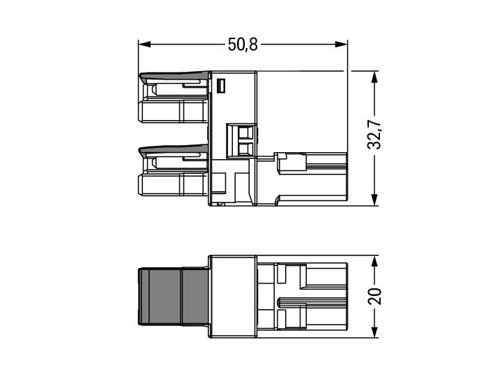

Ч-образный распределительный соединитель; однонаправленные; 1 штекер / 2 розетки; 2-пол.; 100% защита от неправильного подсоединения; съемные

Contact materialCopper or copper alloy, surface-treated
Contact type (pluggable connector)Socket/plug
Country of originDE
Degree of protectionIP20
Габариты: глубина51 mm / 2.008 inch
Fire load0.259 MJ
Flammability class per UL94V0
GTIN4050821531210
Height32.7 mm / 1.287 inch
Insulating materialPolyamide 66 (PA 66)
Legend (ratings)(III / 3) ≙ Overvoltage category III / Pollution degree 3
Locking leverда
Locking of plug-in connectionlocking lever
Marking1 2
Mating force of a plug-in connectionapprox. 20 … 70 N (depending on pole number)
Number of Poles2
Pin spacing10 mm (0.394 inch)
Potential marking1 2
Product Group20 (WINSTA)
Rated current25 A
Rated impulse voltage (III / 3)4 kV
Rated voltage (III / 3)250 В
Retention force of a plug-in connectionwhen locked: > 80N
Surrounding air (operating) temperature-35 … 85 °C
Total number of potentials2
Type of distribution connectorh-distribution connector, unidirectional
Unmating force of a plug-in connectionwhen unlocked: approx. 20 … 70 N (depending on pole number)
Вес15.174 г
Ширина20 mm / 0.787 inch
