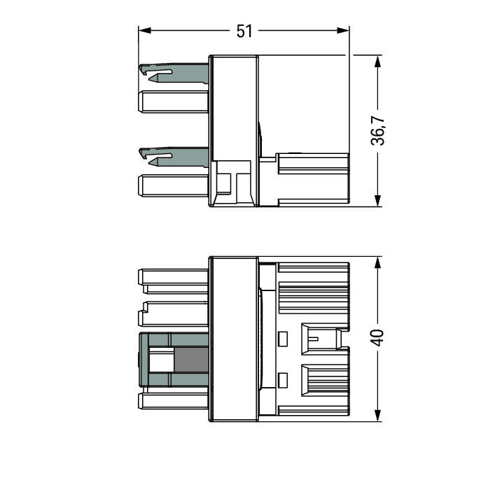

CodingB
Цветpink
Contact materialCopper or copper alloy, surface-treated
Contact type (pluggable connector)Socket/plug
Country of originDE
Degree of protectionIP20
Габариты: глубина51 mm / 2.008 inch
Fire load0.546 MJ
Flammability class per UL94V0
GTIN4050821687641
Height36.7 mm / 1.445 inch
Insulating materialPolyamide 66 (PA 66)
Legend (ratings)(III / 3) ≙ Overvoltage category III / Pollution degree 3
Locking leverда
Locking of plug-in connectionlocking lever
Marking1 2 3 4
Mating force of a plug-in connectionapprox. 20 … 70 N (depending on pole number)
Number of Poles4
Pin spacing10 mm (0.394 inch)
Potential marking1 2 3 4
Product Group20 (WINSTA)
Rated current25 A
Rated impulse voltage (III / 3)6 kV
Rated voltage (III / 3)400 В
Retention force of a plug-in connectionwhen locked: > 80N
Surrounding air (operating) temperature-35 … 85 °C
Total number of potentials4
Type of distribution connectorh-distribution connector, unidirectional
Unmating force of a plug-in connectionwhen unlocked: approx. 20 … 70 N (depending on pole number)
Вес31.955 г
Ширина40 mm / 1.575 inch
