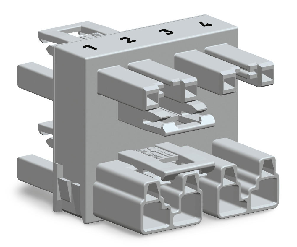

Datasheet Wago 770-1736 — Даташит
Распределительный соединитель; 1 штекер / 3 розетки; 4-пол.; 100% защита от неправильного подсоединения; съемные; 3-канальные
Цены
Купить 770-1736 на РадиоЛоцман.Цены — от 2 233 до 325 ₽ H-многообразие 4-контактный. Kod B. Автобусная приме | |||
770-1736 Wago Оф. дистрибьютор | 2 233 ₽ | ||
770-1736 Wago | 325 ₽ |
Coding | B |
Цвет | pink |
Contact material | Copper or copper alloy, surface-treated |
Contact type (pluggable connector) | Socket/plug |
Country of origin | DE |
Degree of protection | IP20 |

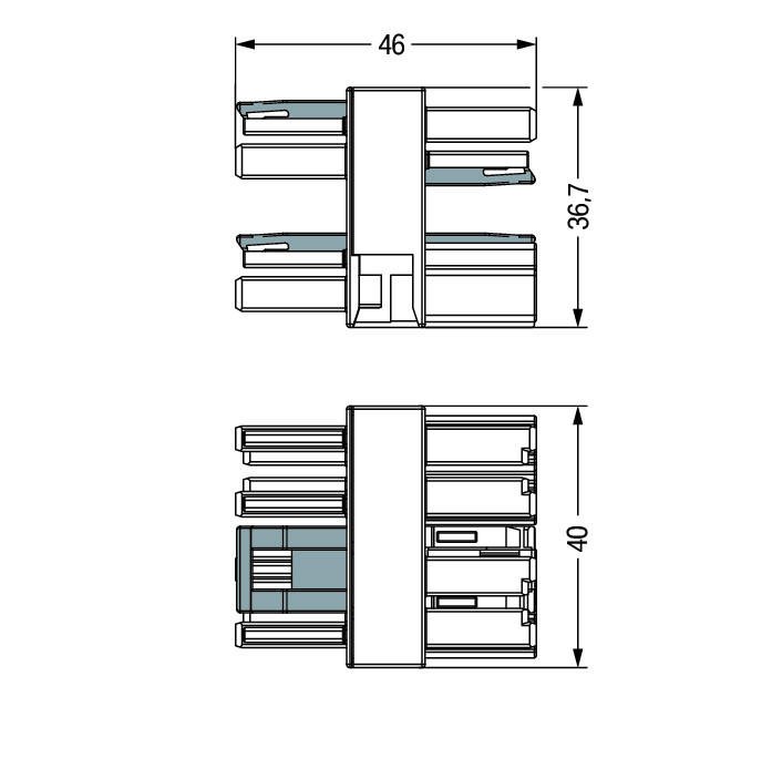

Габариты: глубина | 46 mm / 1.811 inch |
Fire load | 0.621 MJ |
GTIN | 4050821702214 |
Height | 36.7 mm / 1.445 inch |
Legend (ratings) | (III / 3) ≙ Overvoltage category III / Pollution degree 3 |
Locking lever | да |
Locking of plug-in connection | locking lever |
Marking | 1 2 3 4 |
Mating force of a plug-in connection | approx. 20 … 70 N (depending on pole number) |
Number of Poles | 4 |
Pin spacing | 10 mm (0.394 inch) |
Potential marking | 1 2 3 4 |
Product Group | 20 (WINSTA) |
Rated current | 25 A |
Rated impulse voltage (III / 3) | 6 kV |
Rated voltage (III / 3) | 400 В |
Retention force of a plug-in connection | when locked: > 80N |
Surrounding air (operating) temperature | -35 … 85 °C |
Total number of potentials | 4 |
Type of distribution connector | Distribution connector, 3-way |
Unmating force of a plug-in connection | when unlocked: approx. 20 … 70 N (depending on pole number) |
Вес | 36.495 г |
Ширина | 40 mm / 1.575 inch |
