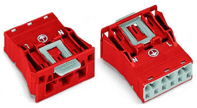

Защелкивающийся штекер; 3-пол.; Код. P

Actuation type | Operating tool Push-in |
Clamping spring material | Chrome nickel spring steel (CrNi) |
Coding | P |
Цвет | red |
Connection technology | Push-in CAGE CLAMP® |
Connector connection type | for conductors |
Contact material | Copper or copper alloy, surface-treated |
Contact type (pluggable connector) | Male connector/plug |
Country of origin | DE |
Degree of protection | IP20 |

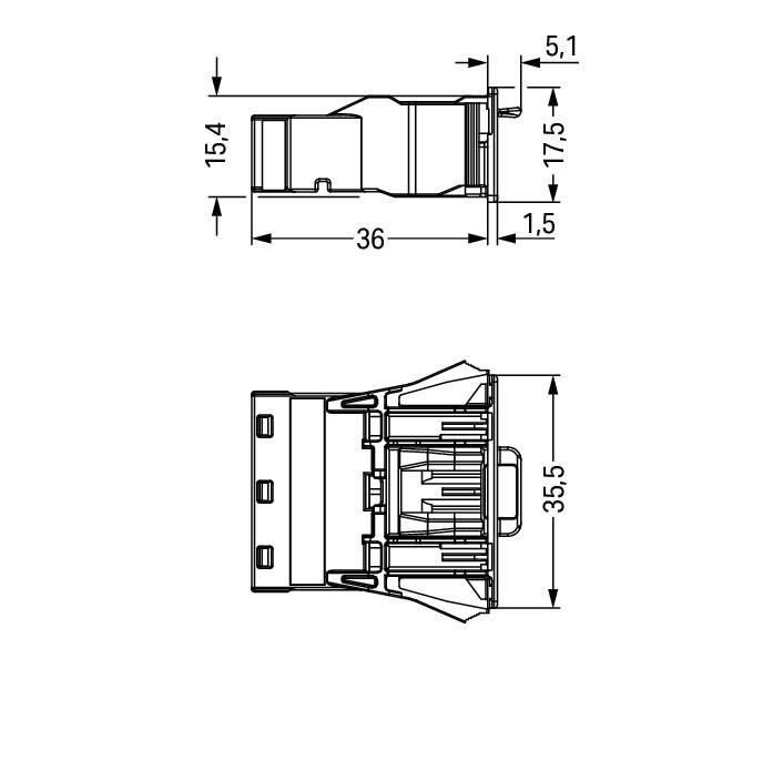

Габариты: глубина | 36 mm / 1.417 inch |

Gehäuseblechstärke | 0.5 … 2 mm / 0.02 … 0.079 inch |

Height | 17.5 mm / 0.689 inch |

Locking lever | да |
Locking of plug-in connection | locking lever |
Marking | L ⏚ N |
Mating force of a plug-in connection | approx. 20 … 70 N (depending on pole number) |
Mismating protection | Yes |
Mounting type | Snap-in |

Ширина | 35.5 mm / 1.398 inch |
