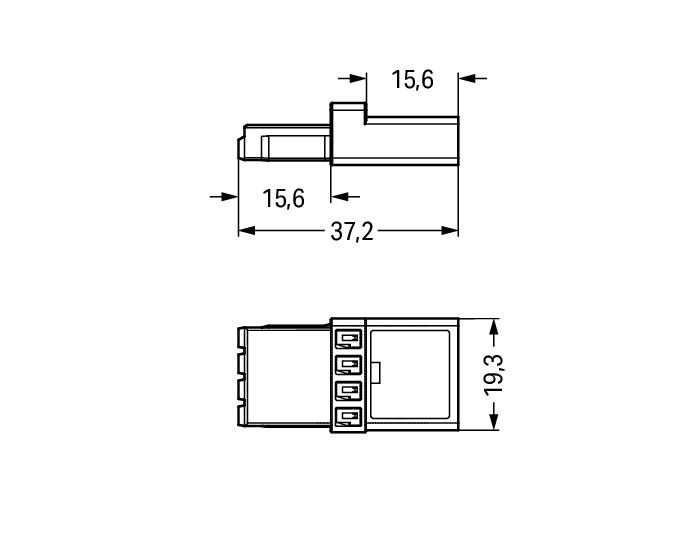

Wago 890-604
CodingA
Цветblack
Contact materialCopper or copper alloy, surface-treated
Contact type (pluggable connector)Socket/plug
Country of originDE
Degree of protectionIP20
Габариты: глубина37.2 mm / 1.465 inch
Flammability class per UL94V0
GTIN4055143231558
Height10.5 mm / 0.413 inch
Insulating materialPolyamide 66 (PA 66)
Legend (ratings)(III / 3) ≙ Overvoltage category III / Pollution degree 3
Locking leverда
Locking of plug-in connectionlocking lever
Mating force of a plug-in connectionapprox. 20 … 70 N (depending on pole number)
Mismating protectionYes
Number of Poles4
Pin spacing4.4 mm (0.173 inch)
Rated current16 A
Rated impulse voltage (III / 3)6 kV
Rated voltage (III / 3)400 В
Retention force of a plug-in connectionwhen locked: > 80N
Surrounding air (operating) temperature-35 … 85 °C
Total number of potentials4
Type of distribution connectorIntermediate coupler
Unmating force of a plug-in connectionwhen unlocked: approx. 20 … 70 N (depending on pole number)
Вес4.6 г
Ширина19.3 mm / 0.76 inch
