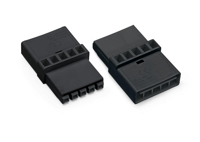

Промежуточный каплер; 1 штекер / 1 розетка; 5-пол.; 100% защита от неправильного подсоединения
Цены
Купить 890-605 на РадиоЛоцман.Цены — от 606 до 88 ₽ Промежуточная связь. 1x мужчины / 1x Bu | |||
890-605 Wago Оф. дистрибьютор | 606 ₽ | ||
890-605 Wago | 690 ₽ | ||
890-605 Wago | 88 ₽ |
Coding | A |
Цвет | black |
Contact material | Copper or copper alloy, surface-treated |
Contact type (pluggable connector) | Socket/plug |
Country of origin | DE |
Degree of protection | IP20 |

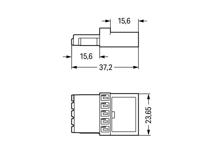

Габариты: глубина | 37.2 mm / 1.465 inch |
Fire load | 0.094 MJ |
GTIN | 4050821295433 |
Height | 10.5 mm / 0.413 inch |
Legend (ratings) | (III / 3) ≙ Overvoltage category III / Pollution degree 3 |
Locking lever | да |
Locking of plug-in connection | locking lever |
Mating force of a plug-in connection | approx. 20 … 70 N (depending on pole number) |
Mismating protection | Yes |
Number of Poles | 5 |
Pin spacing | 4.4 mm (0.173 inch) |
Product Group | 20 (WINSTA) |
Rated current | 13 A |
Rated impulse voltage (III / 3) | 6 kV |
Rated voltage (III / 3) | 400 В |
Retention force of a plug-in connection | when locked: > 80N |
Surrounding air (operating) temperature | -35 … 85 °C |
Total number of potentials | 5 |
Type of distribution connector | Intermediate coupler |
Unmating force of a plug-in connection | when unlocked: approx. 20 … 70 N (depending on pole number) |
Вес | 5.7 г |
Ширина | 23.65 mm / 0.931 inch |
