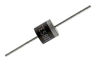

Краткое содержание документа:
1N4148 & 1N4448 Fast Switching Diode
Features: D Fast Switching Speed D General Purpose Rectification D Silicon Epitaxial Planar Construction Mechanical Data: D Case: DO-35 D Leads: Solderable per MIL-STD-202, Method 208 D Polarity: Cathode Band D Marking: Type Number D Weight: 0.13 grams (approx.) Absolute Maximum Ratings: (TA = +25°C, unless otherwise specified) Non-Repetitive Peak Reverse Voltage, VRM .
. . . . . . . . . . . . . . . . . . . . . . . . . . . . . . . . . . . . . . . . . 100V Peak Repetitive Reverse Voltage, VRRM . . . . . . . . . . . . . . . . . . . . . . . . . . . . . . . . . . . . . . . . . . . . . . . 75V Working Peak Reverse Voltage, VRWM . . . . . . . . . . . . . . . . . . . . . . . . . . . . . . . . . . . . . . . . . . . . . . . . 75V DC Blocking Voltage, VR . . . . . . . . . . . . . . . . . . . . . . . . . . . . . . . . . . . . . . . . . . . . . . . . . . . . . . . . . . . . 75V RMS Reverse Voltage, VR(RMS) . . . . . . . . . . . . . . . . . . . . . . . . . . . .
  • Diode Type: Standard Recovery
  • Repetitive Reverse Voltage Vrrm Max: 75 В
  • Forward Current If(AV): 300 мА
  • Forward Voltage VF Max: 1 В
  • Reverse Recovery Time trr Max: 4 нс
  • Forward Surge Current Ifsm Max: 2 А
  • Тип корпуса: DO-35
  • Количество выводов: 2
  • SVHC: No SVHC (15-Dec-2010)
  • Current Ifsm: 1 А
  • Температура перехода максимальная: 175°C
  • Способ монтажа: Axial Leaded
RoHS: есть
