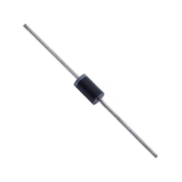

NTE579
Silicon Axial Lead Rectifier
Description: The NTE579 is a Schottky Barrier Rectifier in a DO27 type axial lead package designed for use in low­voltage, high frequency inverters, free wheeling diodes, and polarity protection diodes.
Features: D Low Reverse Current D Low Stored Charge, Majority Carrier Conduction D Low Power Loss/High Efficiency D Highly Stable Oxide Passivated Junction D Guard­Ring for Stress Protection D Low Forward Voltage D 150°C Operating Junction Temperature D High Surge Capacity Absolute Maximum Ratings: Peak Repetitive Reverse Voltage, VRRM . . . . . . . . . . . . . . . . . . . . . . . . . . . . . . . . . . . . . . . . . . . . . . 90V Working Peak Reverse Voltage, VRWM . . . . . . . . . . . . . . . . . . . . . . . . . . . . . . . . . . . . . . . . . . . . . . . . 90V DC Blocking Voltage, VR . . . . . . . . . . . . . . . . . . . . . . . . . . . . . . . . . . . . . . . . . . . . . . . . . . . . . . . . . . . . 90V Average Rectified Forward Current, IO (TA =
  • Diode Type: Schottky
  • Repetitive Reverse Voltage Vrrm Max: 90 В
  • Forward Current If(AV): 3 А
  • Forward Voltage VF Max: 790 мВ
  • Forward Surge Current Ifsm Max: 150 А
