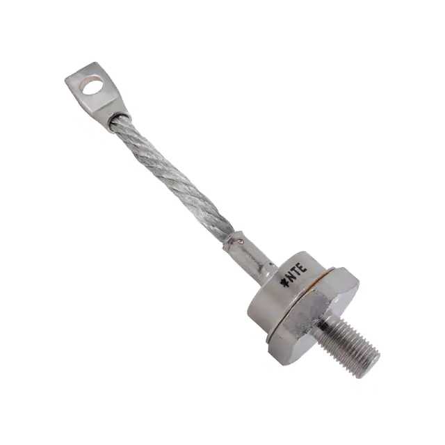

Производитель: NTE Electronics
Описание: STANDARD диод, 150 А, 600 В, DO-8
data sheetСкачать Data Sheet
Краткое содержание документа:
NTE6154 thru NTE6165
Silicon Industrial Rectifier 150 Amp, DO8
Description: The NTE6154 through NTE6165 power rectifiers are stud mounted DO8 type packages.
Because the silicon junction is carefully fitted within a glass-to-metal hermetically sealed case, reliable operation is assured even with extreme humidity and under other severe environmental conditions. These power rectifiers are ideal for a broad range of commercial uses including power supplies, ultrasonic systems, inverters, welders, emergency generators, battery chargers, DC motors, and motor controls. Features: D Standard DO8 Type Package D Available in Standard (Cathode to Case) and Reverse (Anode to Case) Polarity D Recommended Stud Mounting Torque: 120in. lbs. Lubricated. Electrical Ratings: Peak Reverse Voltage, PRV NTE6154, NTE6155* . . . . . . . . . . . . . . . . . . . . . . . . . . . . . . . . . . . . . . . . . . . . . . . . . . . . . . . . 400V NTE6158, NTE6159* . . . . . . . . . . . . . . . . . . . . . . . . . . .
  • Diode Type: Standard Recovery
  • Repetitive Reverse Voltage Vrrm Max: 600 В
  • Forward Current If(AV): 150 А
  • Forward Voltage VF Max: 1.1 В
  • Forward Surge Current Ifsm Max: 2100 А
RoHS: есть
На английском языке: Datasheet NTE6157 - NTE Electronics STANDARD DIODE, 150 A, 600 V, DO-8
