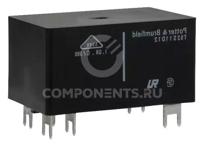

Описание: Реле, мощность, PCB, 24 В постоянный ток, 30 А
data sheetСкачать Data Sheet
Краткое содержание документа:
General Purpose Relays Industrial Relays
Potter & Brumfield
T92 Series Two-pole 30A PCB or Panel Mount Relay
n n n n n n n
30A, 2 form A (NO) and 2 form C (CO) switching capability Designed to control compressor loads to 3.5 tons, 110LRA / 25.3FLA Meets requirements of UL 508 and UL 873 spacings - 8mm through air, 9.5mm over surface Meets requirements of VDE 8mm spacing, 4kV dielectric coil-tocontact Meets requirements of UL Class F construction UL approved for 600VAC switching (1.5HP) New screw terminal version (consult factory for availability, ratings)
  • Тип реле: Power
  • Coil Voltage VDC Nom: 24 В
  • Contact Current Max: 30 А
  • Coil Resistance: 350 Ом
  • Coil Type: DC, Monostable
  • Operating Power Nom: 1.7 Вт
  • Способ монтажа: PCB
  • Габариты: высота: 30.73 мм
  • Внешняя ширина: 34.54 мм
  • External Depth: 52.32 мм
  • Конфигурация контактов: DPST-NO
