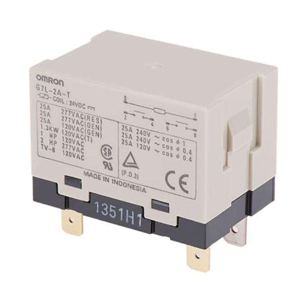

General Purpose Relay
G7L
· Ideally suited for high-inrush fluid pump controls: pool/spa, water processing, emergency, chemical industry, etc.
· High-capacity, high-withstand voltage relay with no contact chattering for momentary voltage drops up to 50% of rated voltage. · UL Class B construction standard. · Wide-range AC-activated coil that handles 100 to 120 VAC at either 50 or 60 Hz. · Miniature hinge for maximum switching capacity, particularly for inductive loads. · Flame resistant materials (UL94V-0-qualifying) used for all insulation material. · Quick-connect, screw, and PCB terminals available. · Standard models are UL, CSA, and TUV approved; VDE/IEC 950 versions are now available. Meet pollution degree 3, Material Group II & III.
Ordering Information
To Order: Select the part number and add the desired coil voltage rating (e.g., G7L-1A-T-CB-AC100/120). Type E bracket (see note 1) E bracket (see note 1) (with test button) Upper bracket Upper bracket (with test button) PCB mou
  • Тип реле: General Purpose
  • Coil Voltage VDC Nom: 48 В
  • Contact Current Max: 25 А
  • Coil Resistance: 1.22 кОм
  • Конфигурация контактов: DPST-NO
  • Coil Type: DC
  • Coil Current: 40 мА
  • Operating Power Nom: 1.9 Вт
  • Способ монтажа: Panel
  • Габариты: высота: 53 мм
  • Внешняя ширина: 33.5 мм
  • External Depth: 52.5 мм
  • SVHC: No SVHC (20-Jun-2011)
