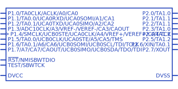

ADCADC10 - 8ch
AESN/A
Active Power330 uA/MHz
Additional FeaturesWatchdog,Temp Sensor,Brown Out Reset,IrDA
BSLUART
CPUMSP430
Comparators8
Featuredg2
Тактовая частота16 МГц
GPIO Pins24
I2C1
Max VCC3.6
Min VCC1.8
MultiplierN/A
Non-volatile Memory1 KB
Рабочий диапазон температурот -40 до 85 C
Package GroupPDIP
Package Size: mm2:W x LSee datasheet (PDIP) PKG
RAM0.25 KB
RatingCatalog
SPI1
Special I/OCapacitive Touch I/O
Standby Power0.7 LPM3-uA
Timers - 16-bit2
UART1
Wakeup Time1.5 us
