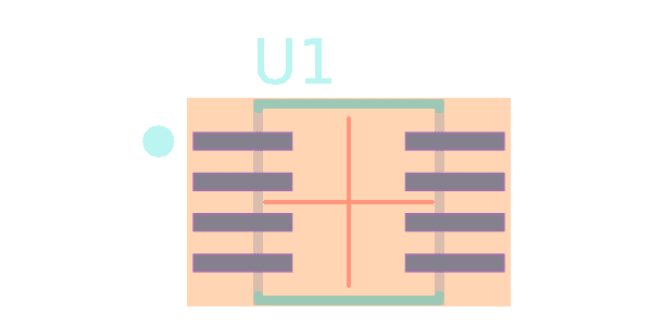

| Серия | SN74LVC2G126 |
| Модель | SN74LVC2G126DCTR |
Буферный вентиль с двойной шиной и выходами с 3 состояниями 8-SM8 от -40 до 125

| Pin | 8 | 8 |
| Package Type | DCT | DCT |
| Industry STD Term | SSOP | SSOP |
| JEDEC Code | R-PDSO-G | R-PDSO-G |
| Package QTY | 3000 | 3000 |
| Carrier | LARGE T&R | LARGE T&R |
| Маркировка | C26 | Z |
| Width (мм) | 2.8 | 2.8 |
| Length (мм) | 2.95 | 2.95 |
| Thickness (мм) | 1.29 | 1.29 |
| Pitch (мм) | .65 | .65 |
| Max Height (мм) | 1.3 | 1.3 |
| Mechanical Data | Скачать | Скачать |
| 3-State Output | Yes |
| Bits | 2 |
| F @ Nom Voltage(Max) | 150 Mhz |
| Gate Type | BUFFER |
| ICC @ Nom Voltage(Max) | 0.01 мА |
| Logic | True |
| Рабочий диапазон температур | от -40 до 125 C |
| Output Drive (IOL/IOH)(Max) | 32/-32 мА |
| Package Group | SM8 |
| Package Size: mm2:W x L | 8SM8: 12 mm2: 4 x 2.95(SM8) PKG |
| Rating | Catalog |
| Schmitt Trigger | No |
| Special Features | Ioff,down translation to Vcc,low power,3-state |
| Sub-Family | Non-Inverting Buffer/Driver |
| Technology Family | LVC |
| VCC(Max) | 5.5 В |
| VCC(Min) | 1.65 В |
| Voltage(Nom) | 1.8,2.5,3.3,5 В |
| tpd @ Nom Voltage(Max) | 9.8,4.9,4,3.2 нс |
