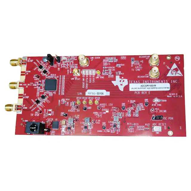

| ADC32RF80IRRHR Texas Instruments | 167 537 ₽ | ||
| ADC32RF80EVM Texas Instruments | 551 030 ₽ | ||
| ADC32RF80EVM Texas Instruments | 606 403 ₽ | ||
| ADC32RF80IRMPT Texas Instruments | по запросу | ||
