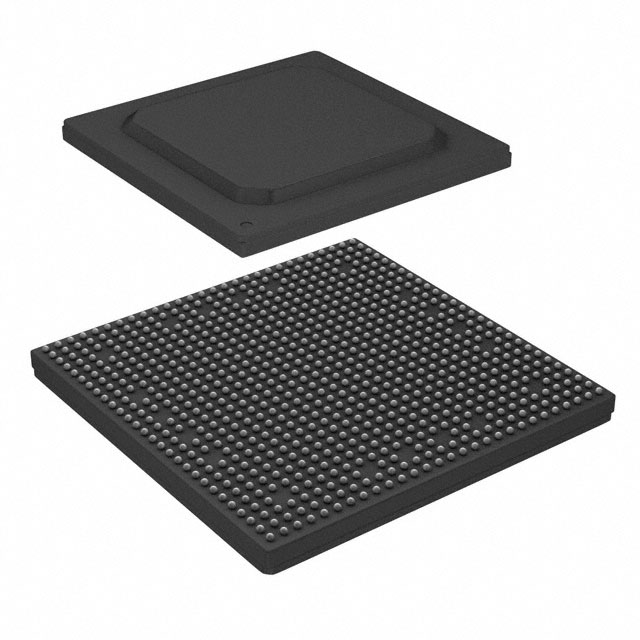

AM5726BABCX | AM5726BABCXA | AM5726BABCXAR | AM5726BABCXEA | |
Статус продукта | В производстве | В производстве | В производстве | В производстве |
Доступность образцов у производителя | Да | Да | Нет | Да |
N | 1 | 2 | 3 | 4 |
Pin | 760 | 760 | 760 | 760 |
Package Type | ABC | ABC | ABC | ABC |
Industry STD Term | FCBGA | FCBGA | FCBGA | FCBGA |
JEDEC Code | S-PBGA-N | S-PBGA-N | S-PBGA-N | S-PBGA-N |
Package QTY | 60 | 60 | 250 | 1 |
Carrier | JEDEC TRAY (5+1) | JEDEC TRAY (5+1) | LARGE T&R | JEDEC TRAY (5+1) |
Маркировка | AM5726BABCX | AM5726BABCXA | SITARATM | SITARATM |
Width (мм) | 23 | 23 | 23 | 23 |
Length (мм) | 23 | 23 | 23 | 23 |
Thickness (мм) | 2.39 | 2.39 | 2.39 | 2.39 |
Pitch (мм) | .8 | .8 | .8 | .8 |
Max Height (мм) | 2.96 | 2.96 | 2.96 | 2.96 |
Mechanical Data | Скачать | Скачать | Скачать | Скачать |
Parameters / Models | AM5726BABCX![]() | AM5726BABCXA![]() | AM5726BABCXAR![]() | AM5726BABCXEA![]() |
ARM CPU | 2 ARM Cortex-A15 | 2 ARM Cortex-A15 | 2 ARM Cortex-A15 | 2 ARM Cortex-A15 |
ARM MHz, Max. | 1500 | 1500 | 1500 | 1500 |
ARM MIPS, Max. | 10500 | 10500 | 10500 | 10500 |
Application | Communications Equipment,Enterprise Systems,Industrial,Personal Electronics | Communications Equipment,Enterprise Systems,Industrial,Personal Electronics | Communications Equipment,Enterprise Systems,Industrial,Personal Electronics | Communications Equipment,Enterprise Systems,Industrial,Personal Electronics |
CAN | 2 | 2 | 2 | 2 |
Co-Processor, s | 2 ARM Cortex-M4,4 PRU-ICSS | 2 ARM Cortex-M4,4 PRU-ICSS | 2 ARM Cortex-M4,4 PRU-ICSS | 2 ARM Cortex-M4,4 PRU-ICSS |
DMA, Ch | 64-Ch EDMA | 64-Ch EDMA | 64-Ch EDMA | 64-Ch EDMA |
DRAM | DDR3,DDR3L | DDR3,DDR3L | DDR3,DDR3L | DDR3,DDR3L |
DSP | 2 C66x | 2 C66x | 2 C66x | 2 C66x |
DSP MHz, Max. | 750 | 750 | 750 | 750 |
EMAC | 10/100/1000,2-Port 1Gb Switch,4-Port 10/100 PRU EMAC | 10/100/1000,2-Port 1Gb Switch,4-Port 10/100 PRU EMAC | 10/100/1000,2-Port 1Gb Switch,4-Port 10/100 PRU EMAC | 10/100/1000,2-Port 1Gb Switch,4-Port 10/100 PRU EMAC |
General Purpose Memory | 1 16-bit (GPMC, NAND flash,NOR Flash,SRAM) | 1 16-bit (GPMC, NAND flash,NOR Flash,SRAM) | 1 16-bit (GPMC, NAND flash,NOR Flash,SRAM) | 1 16-bit (GPMC, NAND flash,NOR Flash,SRAM) |
I2C | 5 | 5 | 5 | 5 |
IO Supply, В | 1.8,3.3 | 1.8,3.3 | 1.8,3.3 | 1.8,3.3 |
Industrial Protocols | 1588,EtherCAT,EtherNet/IP,POWERLINK,PROFIBUS,PROFINET RT/IRT,SERCOS III | 1588,EtherCAT,EtherNet/IP,POWERLINK,PROFIBUS,PROFINET RT/IRT,SERCOS III | 1588,EtherCAT,EtherNet/IP,POWERLINK,PROFIBUS,PROFINET RT/IRT,SERCOS III | 1588,EtherCAT,EtherNet/IP,POWERLINK,PROFIBUS,PROFINET RT/IRT,SERCOS III |
MMC/SD | 4 | 4 | 4 | 4 |
McASP | 8 | 8 | 8 | 8 |
On-Chip L1 Cache | 32KB (L1D and L1I ARM Cortex-A15) | 32KB (L1D and L1I ARM Cortex-A15) | 32KB (L1D and L1I ARM Cortex-A15) | 32KB (L1D and L1I ARM Cortex-A15) |
On-Chip L2 Cache | 2MB (ARM Coxtex-A15) | 2MB (ARM Coxtex-A15) | 2MB (ARM Coxtex-A15) | 2MB (ARM Coxtex-A15) |
Operating Systems | Android,Integrity,Linux,Neutrino,Nucleus,TI-RTOS,VxWorks,Windows Embedded CE | Android,Integrity,Linux,Neutrino,Nucleus,TI-RTOS,VxWorks,Windows Embedded CE | Android,Integrity,Linux,Neutrino,Nucleus,TI-RTOS,VxWorks,Windows Embedded CE | Android,Integrity,Linux,Neutrino,Nucleus,TI-RTOS,VxWorks,Windows Embedded CE |
Рабочий диапазон температур, C | от -40 до 105,0 до 90 | от -40 до 105,0 до 90 | от -40 до 105,0 до 90 | от -40 до 105,0 до 90 |
Other Hardware Acceleration | Crypto Accelerator | Crypto Accelerator | Crypto Accelerator | Crypto Accelerator |
Other On-Chip Memory | 2.5 MB w/ECC | 2.5 MB w/ECC | 2.5 MB w/ECC | 2.5 MB w/ECC |
PCI/PCIe | 2 PCIe | 2 PCIe | 2 PCIe | 2 PCIe |
PWM, Ch | 3 | 3 | 3 | 3 |
Package Group | FCBGA | FCBGA | FCBGA | FCBGA |
QSPI | 1 | 1 | 1 | 1 |
RTC | 1 | 1 | 1 | 1 |
Rating | Catalog | Catalog | Catalog | Catalog |
SATA | 1 | 1 | 1 | 1 |
SPI | 4 | 4 | 4 | 4 |
Serial I/O | CAN,I2C,SPI,UART,USB | CAN,I2C,SPI,UART,USB | CAN,I2C,SPI,UART,USB | CAN,I2C,SPI,UART,USB |
UART, SCI | 10 | 10 | 10 | 10 |
USB | 2 | 2 | 2 | 2 |
USB 2.0 | 1 | 1 | 1 | 1 |
USB 3.0 | 1 | 1 | 1 | 1 |
Video Port, Configurable | 6+ | 6+ | 6+ | 6+ |
eCAP | 3 | 3 | 3 | 3 |
eQEP | 3 | 3 | 3 | 3 |
Экологический статус
RoHS | Совместим | Совместим | Совместим | Совместим |
