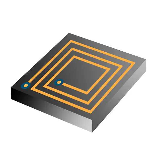

Tag-it HF-I Type 5 NFC, ISO15693 Transponder, 4 mm Г— 4 mm
RF37S114 Tag-itв„ў HF-I Type 5 NFC, ISO/IECВ 15693 Transponder, 4 mm Г— 4 mm datasheet
