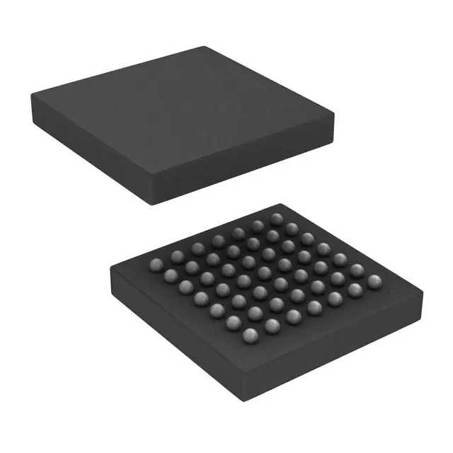

SCAN921023SLC | SCAN921023SLC/NOPB | |
Статус продукта | Не рекомендуется для новых разработок | В производстве |
Доступность образцов у производителя | Нет | Нет |
N | 1 | 2 |
Pin | 49 | 49 |
Package Type | NZA | NZA |
Industry STD Term | NFBGA | NFBGA |
JEDEC Code | S-PBGA-N | S-PBGA-N |
Package QTY | 416 | 416 |
Маркировка | SLC | SLC |
Width (мм) | 7 | 7 |
Length (мм) | 7 | 7 |
Thickness (мм) | 1.4 | 1.4 |
Pitch (мм) | .8 | .8 |
Max Height (мм) | 1.5 | 1.5 |
Mechanical Data | Скачать | Скачать |
Parameters / Models | SCAN921023SLC![]() | SCAN921023SLC/NOPB![]() |
Approx. Price (US$) | 4.80 | 1ku | |
Clock Max(MHz) | 66 | |
Clock Min(MHz) | 20 | |
Communications | Yes | |
Compression Ratio | 10 to 1 | |
Data Throughput(Mb/s) | 660 | |
ESD(kV) | 2 | |
Function | Serializer | |
ICC(Max)(mA) | 130 | |
Input Compatibility | LVTTL | |
JTAG1149.1 | Yes | |
No. of Tx | 1 | |
Operating Temperature Range(C) | -40 to 85 | |
Output Compatibility | LVDS BLVDS | |
PLL Frequency(MHz) | 20-66 | |
Package Group | NFBGA | |
Package Size: mm2:W x L (PKG) | 49NFBGA: 49 mm2: 7 x 7(NFBGA) | |
Parallel Bus Width | 10 | |
Parallel Bus Width(bits) | 10 | |
Payload/Channel(Mbps) | 660 | |
Power Consumption(mW) | 248 | |
Rating | Catalog | |
Sensing & Imaging | Yes | |
Start/Stop Bit | Yes | |
Supply Voltage(s)(V) | 3.3 | |
SupplyVoltage(Volt) | 3.3 | |
Total Throughput(Mbps) | 660 |
