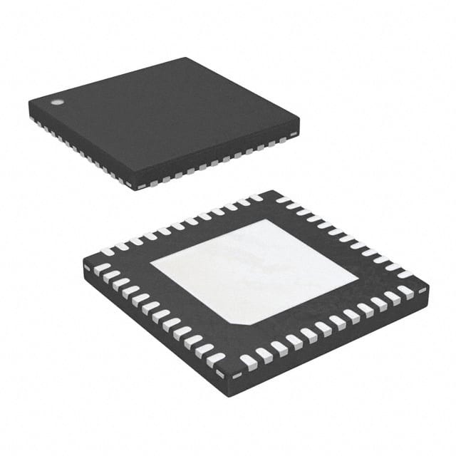

Трехфазный понижающий ШИМ-контроллер VR11.1 со встроенными драйверами MOSFET, DEM, GVOT и Droop Pin

Корпус48 Ld QFN48 Ld QFN T+R48 Ld QFN48 Ld QFN T+R
Parameters / ModelsISL6333CRZISL6333CRZ-TISL6333IRZISL6333IRZ-T
ApplicationsVR11.1VR11.1VR11.1VR11.1
DescriptionVR11.1 Three-Phase Buck PWM Controller with Integrated MOSFET Drivers, DEM, GVOT, and Droop PinVR11.1 Three-Phase Buck PWM Controller with Integrated MOSFET Drivers, DEM, GVOT, and Droop PinVR11.1 Three-Phase Buck PWM Controller with Integrated MOSFET Drivers, DEM, GVOT, and Droop PinVR11.1 Three-Phase Buck PWM Controller with Integrated MOSFET Drivers, DEM, GVOT, and Droop Pin
DroopYesYesYesYes
IOUT (max) (A)100100100100
Integrated MOSFET Driver(s)YesYesYesYes
Max # of Outputs1111
Max # of Phases3333
Рабочий диапазон температурот -40 до 85от -40 до 85от -40 до 85от -40 до 85
Peak Temp260°C260°C260°C260°C
Qualification LevelStandardStandardStandardStandard
VBIAS (V)4.75 to 5.254.75 to 5.254.75 to 5.254.75 to 5.25
VIDYesYesYesYes
VIN (max) (V)12121212
VIN (min) (V)5555
VOUT (max) (V)1.61.61.61.6
VOUT (min) (V)0.50.50.50.5
