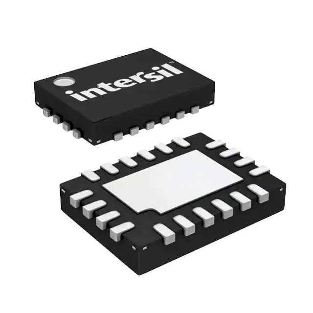

| Производитель | Intersil |
| Серия | ISL95813 |
Однофазный контроллер ядра для VR12.6

| ISL95813HRZ | ISL95813HRZ-T | ISL95813IRZ | ISL95813IRZ-T | |
| N | 1 | 2 | 3 | 4 |
| Корпус | 20 Ld QFN | 20 Ld QFN T+R | 20 Ld QFN | 20 Ld QFN T+R |
| Parameters / Models | ISL95813HRZ | ISL95813HRZ-T | ISL95813IRZ | ISL95813IRZ-T |
| Applications | Notebook,Tablets, Ultrabooks, and AIO | Notebook,Tablets, Ultrabooks, and AIO | Notebook,Tablets, Ultrabooks, and AIO | Notebook,Tablets, Ultrabooks, and AIO |
| Description | Single Phase Core Controller for VR12.6 | Single Phase Core Controller for VR12.6 | Single Phase Core Controller for VR12.6 | Single Phase Core Controller for VR12.6 |
| IOUT (max) (A) | 30 | 30 | 30 | 30 |
| IS (min) | .001 mA | .001 mA | .001 mA | .001 mA |
| IS (typ) | 3.5 mA | 3.5 mA | 3.5 mA | 3.5 mA |
| Рабочий диапазон температур | от -40 до 100 | от -40 до 100 | от -40 до 100 | от -40 до 100 |
| Peak Temp | 260°C | 260°C | 260°C | 260°C |
| Qualification Level | Standard | Standard | Standard | Standard |
| VBIAS (max) | 5.25 V | 5.25 V | 5.25 V | 5.25 V |
| VBIAS (min) | 4.75 V | 4.75 V | 4.75 V | 4.75 V |
| VID | Yes | Yes | Yes | Yes |
| VIN (max) (V) | 25 | 25 | 25 | 25 |
| VIN (min) (V) | 4.6 | 4.6 | 4.6 | 4.6 |
| VOUT (max) (V) | 2.3 | 2.3 | 2.3 | 2.3 |
| VOUT (min) (V) | .5 | .5 | .5 | .5 |
| VRM | VR12.6 | VR12.6 | VR12.6 | VR12.6 |
