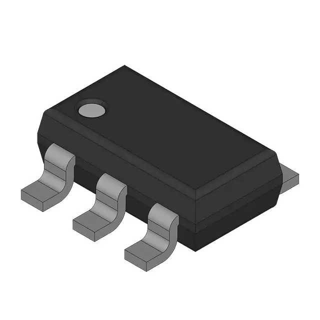

EL5111IWT-T7 | EL5111IWT-T7A | EL5111IWTZ-T7 | EL5111IWTZ-T7A | EL5111IYE | EL5111IYE-T13 | EL5111IYE-T7 | EL5111IYEZ | EL5111IYEZ-T13 | EL5111IYEZ-T7 | |
N | 1 | 2 | 3 | 4 | 5 | 6 | 7 | 8 | 9 | 10 |
Корпус | 5 Ld TSOT T+R | 5 Ld TSOT T+R | 5 Ld TSOT T+R | 5 Ld TSOT T+R | 8 Ld | 8 Ld T+R | 8 Ld T+R | 8 Ld MSOP | 8 Ld MSOP T+R | 8 Ld MSOP T+R |
Parameters / Models | EL5111IWT-T7 | EL5111IWT-T7A | EL5111IWTZ-T7 | EL5111IWTZ-T7A | EL5111IYE | EL5111IYE-T13 | EL5111IYE-T7 | EL5111IYEZ | EL5111IYEZ-T13 | EL5111IYEZ-T7 |
Полоса частот | 60 MHz | 60 MHz | 60 MHz | 60 MHz | 60 MHz | 60 MHz | 60 MHz | 60 MHz | 60 MHz | 60 MHz |
Количество каналов | 1 | 1 | 1 | 1 | 1 | 1 | 1 | 1 | 1 | 1 |
Description | 60MHz Rail-to-Rail Input-Output Op Amps | 60MHz Rail-to-Rail Input-Output Op Amps | 60MHz Rail-to-Rail Input-Output Op Amps | 60MHz Rail-to-Rail Input-Output Op Amps | 60MHz Rail-to-Rail Input-Output Op Amps | 60MHz Rail-to-Rail Input-Output Op Amps | 60MHz Rail-to-Rail Input-Output Op Amps | 60MHz Rail-to-Rail Input-Output Op Amps | 60MHz Rail-to-Rail Input-Output Op Amps | 60MHz Rail-to-Rail Input-Output Op Amps |
IOUT | 65 mA | 65 mA | 65 mA | 65 mA | 65 mA | 65 mA | 65 mA | 65 mA | 65 mA | 65 mA |
IS | 2.5 mA | 2.5 mA | 2.5 mA | 2.5 mA | 2.5 mA | 2.5 mA | 2.5 mA | 2.5 mA | 2.5 mA | 2.5 mA |
Рабочий диапазон температур | от -40 до 85 | от -40 до 85 | от -40 до 85 | от -40 до 85 | от -40 до 85 | от -40 до 85 | от -40 до 85 | от -40 до 85 | от -40 до 85 | от -40 до 85 |
Peak Temp | 240°C | 240°C | 260°C | 260°C | 240°C | 240°C | 240°C | 260°C | 260°C | 260°C |
Qualification Level | Standard | Standard | Standard | Standard | Standard | Standard | Standard | Standard | Standard | Standard |
Rail-to-Rail Input | Yes | Yes | Yes | Yes | Yes | Yes | Yes | Yes | Yes | Yes |
Rail-to-Rail Output | Yes | Yes | Yes | Yes | Yes | Yes | Yes | Yes | Yes | Yes |
Скорость нарастания | 75 V/μs | 75 V/μs | 75 V/μs | 75 V/μs | 75 V/μs | 75 V/μs | 75 V/μs | 75 V/μs | 75 V/μs | 75 V/μs |
VS (max) | 16.5 V | 16.5 V | 16.5 V | 16.5 V | 16.5 V | 16.5 V | 16.5 V | 16.5 V | 16.5 V | 16.5 V |
VS (min) | 4.5 V | 4.5 V | 4.5 V | 4.5 V | 4.5 V | 4.5 V | 4.5 V | 4.5 V | 4.5 V | 4.5 V |
