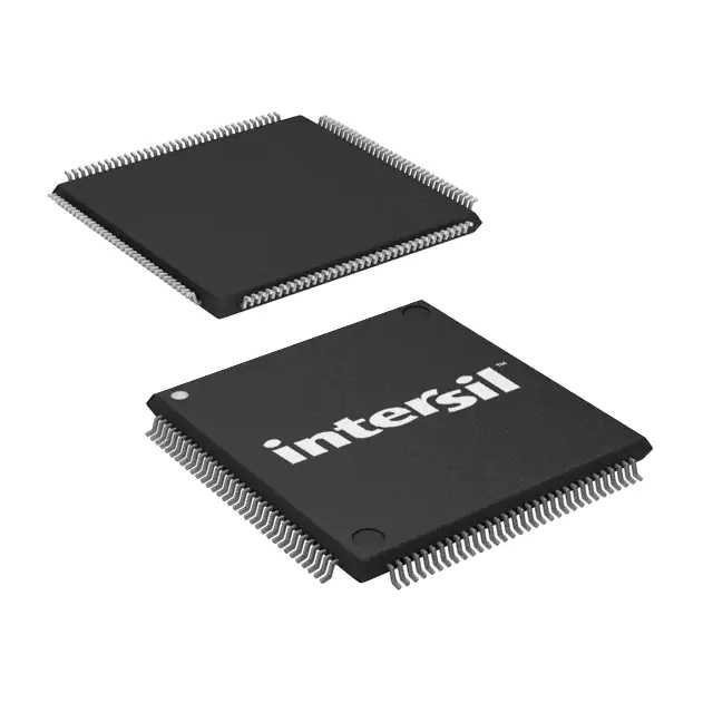

| Производитель | Intersil |
| Серия | TW8836 |
Видеопроцессор ЖК-дисплея с декодером, тройными АЦП, входами LVDS и TTL, MCU, OSD, интерфейсами TCON и LVDS
Купить TW8836 на РадиоЛоцман.Цены — от 81 до 296 630 ₽28 предложений от 16 поставщиков Интегральные микросхемы Линейные микросхемы - Микросхемы обработки видеоинформации | |||
| TW8836-L-EVAL Intersil | 81 ₽ | ||
| TW8836-LB2-CE Renesas | от 240 ₽ | ||
| TW8836-LB2-CE | 713 ₽ | ||
| TW8836-LB2-EVAL Renesas | по запросу | ||
| TW8836-BB2-CR | TW8836-LB2-CE | TW8836AT-LB2-GE | |
| N | 1 | 2 | 3 |
| Корпус | 172 Ld BGA | 128 Ld LQFP | 128 Ld LQFP |
| Parameters / Models | TW8836-BB2-CR | TW8836-LB2-CE | TW8836AT-LB2-GE |
| ADC Input Frequency | 148 MHz | 148 MHz | 148 MHz |
| Analog RGB Input | Yes | Yes | Yes |
| CCFL/LED Controller | No | No | No |
| CVBS Input | Yes | Yes | Yes |
| Color Enhancement | Yes | Yes | Yes |
| Comb Filter | 2D | 2D | 2D |
| De-Interlacer | 2D | 2D | 2D |
| Description | LCD Video Processor with Decoder, Triple ADCs, LVDS and TTL Input, MCU, OSD, TCON and LVDS Interface | LCD Video Processor with Decoder, Triple ADCs, LVDS and TTL Input, MCU, OSD, TCON and LVDS Interface | LCD Video Processor with Decoder, Triple ADCs, LVDS and TTL Input, MCU, OSD, TCON and LVDS Interface |
| Digital RGB/Y CbCr Input | 24 bit | 24 bit | 24 bit |
| Dual View Output | No | No | No |
| External OSD | No | No | No |
| LVDS Input | Yes | Yes | Yes |
| LVDS Output | Yes | Yes | Yes |
| MCU | Integrated | Integrated | Integrated |
| Max Output Resolution | WXGA | WXGA | WXGA |
| Memory Support | No | No | No |
| OSD Colors | 16 Colors / 16-bit Pallette | 16 Colors / 16-bit Pallette | 16 Colors / 16-bit Pallette |
| OSD Font RAM | 379 | 379 | 379 |
| OSD Font ROM | N/A | N/A | N/A |
| OSD Type | Font / SPI bitmap | Font / SPI bitmap | Font / SPI bitmap |
| Рабочий диапазон температур | от -40 до 105 | от -40 до 105 | от -40 до 105 |
| PIP | No | No | No |
| Peak Temp | 260°C | 260°C | 260°C |
| Qualification Level | Standard | Standard | Standard |
| S-Video Input | Yes | Yes | Yes |
| SCART Input | No | No | No |
| TCON Output | Digital | Digital | Digital |
| TTL Output | Yes | Yes | Yes |
| Touch-screen Controller | Yes | Yes | Yes |
| YPbPr Input | Yes | Yes | Yes |
