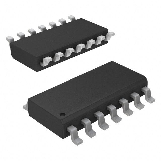

Fault Protected, Extended CMR, RS-485/RS-422 Transceivers with Cable Invert and В±16.5kV ESD
ISL32483E, ISL32485E Datasheet

Корпус14 Ld SOIC14 Ld SOIC T+R14 Ld SOIC T+R
Parameters / ModelsISL32483EIBZISL32483EIBZ-TISL32483EIBZ-T7A
# of Rx111
# of Tx111
Common Mode Voltage RangeВ±25 VВ±25 VВ±25 V
Скорость передачи данных1 Mbps1 Mbps1 Mbps
DescriptionFault Protected, Extended CMR, RS-485/RS-422 Transceivers with Cable Invert and ?16.5kV ESDFault Protected, Extended CMR, RS-485/RS-422 Transceivers with Cable Invert and ?16.5kV ESDFault Protected, Extended CMR, RS-485/RS-422 Transceivers with Cable Invert and ?16.5kV ESD
Devices Allowed on Bus128128128
Fault Voltage LevelВ±60 VВ±60 VВ±60 V
Half/Full DuplexFullFullFull
High ESD?YesYesYes
Hot PlugYesYesYes
ICC2.3 mA2.3 mA2.3 mA
Рабочий диапазон температурот -40 до 85от -40 до 85от -40 до 85
Peak Temp260°C260°C260°C
Qualification LevelStandardStandardStandard
SHDN ICC50 μA50 μA50 μA
Slew Rate LimitedYesYesYes
Tx/Rx EnableYesYesYes
VCC (min)4.5 V4.5 V4.5 V
VL PinNoNoNo
