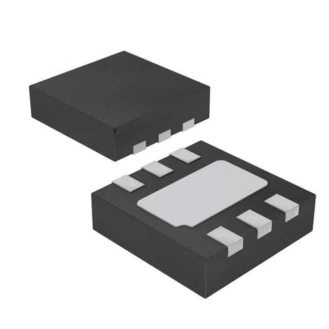

| Parameters / Models | ISL76671AROZ-T7 | ISL76671AROZ-T7A |
| Dark Voltage @ EV=0Lux | .95 mV | .95 mV |
| Delay Time, Falling Edge (Ојs) | 250 | 250 |
| Delay Time, Rising Edge (Ојs) | 350 | 350 |
| Description | Low Power, 100 Lux Optimized, Analog Output Ambient Light Sensor | Low Power, 100 Lux Optimized, Analog Output Ambient Light Sensor |
| Enable Pin? | No | No |
| Fall Time | 155 μs | 155 μs |
| Lux Range (max) | 100 lux | 100 lux |
| Рабочий диапазон температур | от -40 до 105 | от -40 до 105 |
| Output Voltage @ EV=100Lux | 1.85 V | 1.85 V |
| Package Dimensions (mm) | 2.0x2.1x0.70 | 2.0x2.1x0.70 |
| Pb Free? | Yes | Yes |
| Peak Spectral Sensitivity | 550 nm | 550 nm |
| Peak Temp | 260°C | 260°C |
| Qualification Level | Automotive | Automotive |
| Rise Time | 95 μs | 95 μs |
| Supply Current @ EV =100Lux | 23 μA | 23 μA |
| VS (max) | 3 V | 3 V |
| VS (min) | 1.8 V | 1.8 V |
