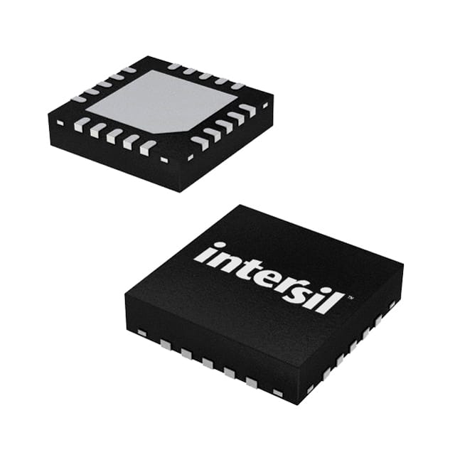

Datasheet Intersil ISL43840 — Даташит
Производитель | Intersil |
Серия | ISL43840 |
Низковольтный аналоговый переключатель с одинарным и двойным питанием, двойной мультиплексор 4–1 с включением
![]() 21 предложений от 19 поставщиков Low-Voltage, Single and Dual Supply, Dual 4 to 1 Multiplexer Analog Switch with Enable | IC MUX/DEMUX DUAL 4X1 20QFN | |||
ISL43840IRZ-T Intersil | 126 ₽ | ||
ISL43840IRZ Renesas | 151 ₽ | ||
ISL43840IRZ-T Intersil | по запросу | ||
ISL43840IR Intersil | по запросу |
ISL43840IR | ISL43840IR-T | ISL43840IRZ | ISL43840IRZ-T | |
N | 1 | 2 | 3 | 4 |
Корпус | 20 Ld QFN | 20 Ld QFN T+R | 20 Ld QFN | 20 Ld QFN T+R |
Parameters / Models | ISL43840IR | ISL43840IR-T | ISL43840IRZ | ISL43840IRZ-T |
Количество каналов | 4 | 4 | 4 | 4 |
Chg Inj | 0.3 pC | 0.3 pC | 0.3 pC | 0.3 pC |
Configuration | Dual | Dual | Dual | Dual |
Description | Low-Voltage, Single and Dual Supply, Dual 4 to 1 Multiplexer Analog Switch with Enable | Low-Voltage, Single and Dual Supply, Dual 4 to 1 Multiplexer Analog Switch with Enable | Low-Voltage, Single and Dual Supply, Dual 4 to 1 Multiplexer Analog Switch with Enable | Low-Voltage, Single and Dual Supply, Dual 4 to 1 Multiplexer Analog Switch with Enable |
Drain Cap | 18 pF | 18 pF | 18 pF | 18 pF |
IS | 0.1 μA | 0.1 μA | 0.1 μA | 0.1 μA |
Leakage | 2 pA | 2 pA | 2 pA | 2 pA |
Рабочий диапазон температур | от -40 до 85 | от -40 до 85 | от -40 до 85 | от -40 до 85 |
Peak Temp | 240°C | 240°C | 260°C | 260°C |
Qualification Level | Standard | Standard | Standard | Standard |
Source Cap | 3 pF | 3 pF | 3 pF | 3 pF |
Switch or MUX | MUX | MUX | MUX | MUX |
TOFF | 18 ns | 18 ns | 18 ns | 18 ns |
TON | 32 ns | 32 ns | 32 ns | 32 ns |
Type of Switch | N/A | N/A | N/A | N/A |
VCC (Dual) (max) | В±6 V | В±6 V | В±6 V | В±6 V |
VCC (Dual) (min) | В±2 V | В±2 V | В±2 V | В±2 V |
VCC (Single) (max) | 12 V | 12 V | 12 V | 12 V |
VCC (Single) (min) | 2 V | 2 V | 2 V | 2 V |
rDS(ON) | 39 Ω | 39 Ω | 39 О© | 39 О© |
