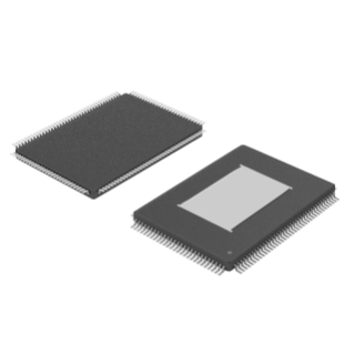

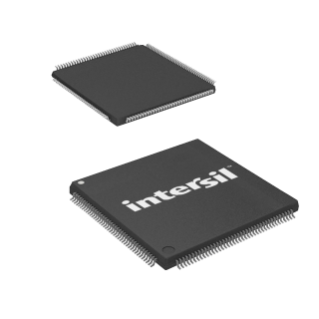

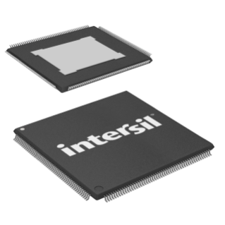

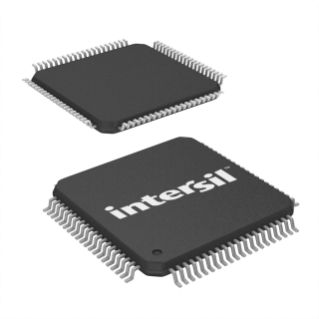

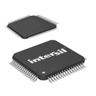

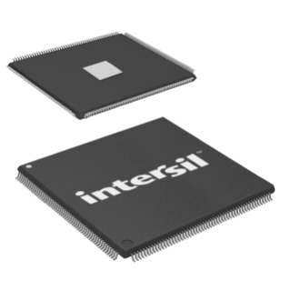

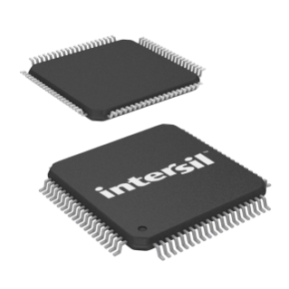

| Parameters / Models | Q100.12x12 | Q128.14x14  | Q128.14x14A  | Q128.14x14C  | Q128.14x20A  | Q128.14x20B  | Q128.14x20C  | Q128.14x20F  | Q144.20x20  | Q144.20x20B  | Q156.14x20 | Q160.24x24  | Q216.24x24  | Q44.7x7 | Q48.7x7A  | Q64.10x10A  | Q64.7x7  | Q80.10x10  | Q80.12x12B  |
| Семейство | LQFP | LQFP | LQFP | LQFP | LQFP | LQFP-TEP | LQFP-TEP | LQFP | LQFP | LQFP | LQFP | LQFP | LQFP | LQFP | LQFP | LQFP | LQFP | LQFP | LQFP |
| Количество выводов | 100 | 128 | 128 | 128 | 128 | 128 | 128 | 128 | 144 | 144 | 156 | 160 | 216 | 44 | 48 | 64 | 64 | 80 | 80 |
| Длина, мм | 12.00 | 14.00 | 14.00 | 14.00 | 20.00 | 20.00 | 20.00 | 20 | 20.00 | 20.00 | 20.00 | 24.00 | 24.00 | 12.00 | |||||
| Ширина, мм | 12.00 | 14.00 | 14.00 | 14.00 | 14.00 | 14.00 | 14.00 | 14 | 20.00 | 20.00 | 14.00 | 24.00 | 24.00 | 12.00 | |||||
| Толщина, мм | 1.40 | 1.40 | 1.40 | 1.40 | 1.40 | 1.40 | 1.40 | 1.40 | 1.40 | 1.40 | 1.40 | 1.40 | 1.40 | ||||||
| Высота макс., мм | 1.60 | 1.60 | 1.60 | 1.60 | 1.60 | 1.60 | 1.60 | 1.60 | 1.60 | 1.60 | 1.60 | 1.60 | 1.60 | 1.60 | 1.45 | 1.60 | 1.60 | 1.60 | |
| Вес, г | 0.504 | 0.673 | 0.79 | 0.67 | 0.9839 | 0.9777 | 0.991 | 0.95 | 1.264 | 1.264 | 0.936 | 1.8693 | 2.02 | 0.159 | 0.174 | 0.345 | 0.182 | 0.33 | 0.5 |
| Шаг выводов, мм | 0.40 | 0.40 | 0.40 | 0.40 | 0.50 | 0.50 | 0.50 | 0.50 | 0.50 | 0.50 | 0.41 | 0.50 | 0.50 | 0.50 | 0.40 | ||||
| Пиковая температура пайки, °C | 235 | 225 | 225 | 225 | 225 | 225 | 235 | 225 | 225 | 220 | 220 | 220 | 235 | 240 | 235 | 235 | 235 | ||
| Пиковая температура для бессвинцовых корпусов, °C | 260 | 260 | 260 | 260 | 260 | 260 | 260 | 260 | 260 | 260 | 260 | 260 | 260 | 260 | 260 | 260 | 260 | 260 | 260 |
| Основные особенности | Top Exposed Pad | Top Exposed Pad | |||||||||||||||||
| Индекс корпуса | Q100.12X12 | Q128.14X14 | Q128.14X14A | Q128.14X14C | Q128.14X20A | Q128.14X20B | Q128.14X20C | Q128.14X20F | Q144.20X20 | Q144.20X20B | Q156.14X20 | Q160.24X24 | Q216.24X24 | Q44.7X7 | Q48.7X7A | Q64.10X10A | Q64.7X7 | Q80.10X10 | Q80.12X12B |
