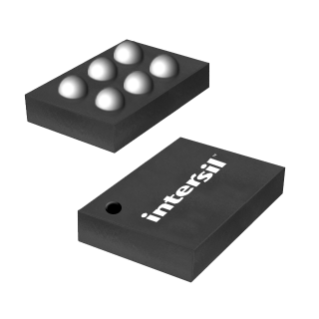

Корпус Intersil WLCSP — Даташит
| Производитель | Intersil |
| Серия | WLCSP |
Пакет масштабирования чипов уровня пластины
| Parameters / Models | W11x11.121![]() | W11x11.121A![]() | W11x11.121B![]() | W13x13.169 | W2x2.4![]() | W2x4.8 | W3x2.6![]() | W3x2.6C![]() | W3x2.6D | W3x3.9A![]() | W3x3.9B![]() | W3x3.9C![]() | W3x3.9D![]() | W3x3.9E![]() | W3x3.9F | W3x3.9H | W3x4.12![]() | W3x4.12A![]() | W3x4.12B![]() | W3x4.12C | W3x5.15![]() | W3x5.15A![]() | W4x3.10A![]() | W4x4.16![]() | W4x4.16B![]() | W4x4.16C![]() | W4x4.16E![]() | W4x4.16F![]() | W4x4.16G![]() | W4x5.20![]() | W4x5.20A![]() | W4x5.20B![]() | W4x5.20C![]() | W4x5.20D![]() | W4x5.20E![]() | W4x5.20F![]() | W4x5.20G![]() | W4x5.20H![]() | W4x5.20J![]() | W4x5.20K![]() | W4x5.20M![]() | W4x5.20N![]() | W4x5.20R | W4x5.20S | W4x6.24![]() | W4x7.28 | W5x5.25![]() | W5x5.25B![]() | W5x5.25E![]() | W5x5.25G | W5x5.25H | W5x6.30A![]() | W5x6.30C![]() | W5x7.28![]() | W5x7.35![]() | W5x7.35C | W5x8.40![]() | W5x8.40A![]() | W6x6.36![]() | W6x6.36B | W6x7.42![]() | W6x7.42B | W6x8.48 | W6x9.54![]() | W6x9.54A | W7x7.49 | W7x8.46![]() | W7x8.52![]() | W7x8.56![]() | W7x8.56A![]() | W8x12.96 | W8x8.64![]() | W8x8.64A![]() | W8x9.72 | W8x9.72A![]() | W8x9.72B | W8x9.72C | W9x11.99 | W9x12.108 | W9x9.62![]() |
| Семейство | WLCSP-TCURDL | WLCSP-TCURDLBC | WLCSP-TCURDL | WLCSP-TKCURDL | WLCSP-BP | WLCSP-BP | WLCSP-BP | WLCSP-BP | WLCSP-BPBC | WLCSP-BP | WLCSP-BP | WLCSP-BP | WLCSP-BPBC | WLCSP-BP | WLCSP-BP | WLCSP-BP | WLCSP-BP | WLCSP-BPBC | WLCSP-BP | WLCSP-BP | WLCSP-TKCURDL | WLCSP-TKCURDLBC | WLCSP-BP | WLCSP-BP | WLCSP-TCURDL | WLCSP-TKCURDLBC | WLCSP-BPBC | WLCSP-BP | WLCSP-BP | WLCSP-BP | WLCSP-BP | WLCSP-BPBC | WLCSP-BPBC | WLCSP-TKCURDLBC | WLCSP-BPBC | WLCSP-BP | WLCSP-TCURDL | WLCSP-BP | WLCSP-TKCURDL | WLCSP-TKCURDLBC | WLCSP-TKCURDL | WLCSP-BP | WLCSP-BP | WLCSP-BP | WLCSP-BP | WLCSP-BP | WLCSP-TKCURDLBC | WLCSP-BP | WLCSP-BP | WLCSP-BP | WLCSP-BP | WLCSP-BP | WLCSP-TKCURDL | WLCSP-BP | WLCSP-BP | WLCSP-BP | WLCSP-BP | WLCSP-BP | WLCSP-TKCURDL | WLCSP-TKCURDL | WLCSP-TKCURDL | WLCSP-TKCURDL | WLCSP | WLCSP-BP | WLCSP-BP | WLCSP-BP | WLCSP-BP | WLCSP-TCURDL | WLCSP-TCURDL | WLCSP-TCURDLBC | WLCSP-BP | WLCSP-BP | WLCSP-TKCURDL | WLCSP-BP | WLCSP-TKCURDL | WLCSP-TKCURDL | WLCSP-BP | |||
| Количество выводов | 121 | 121 | 121 | 169 | 4 | 8 | 6 | 6 | 6 | 9 | 9 | 9 | 9 | 9 | 9 | 9 | 12 | 12 | 12 | 12 | 15 | 15 | 10 | 16 | 16 | 16 | 16 | 16 | 16 | 20 | 20 | 20 | 20 | 20 | 20 | 20 | 20 | 20 | 20 | 20 | 20 | 20 | 20 | 20 | 24 | 28 | 25 | 25 | 25 | 25 | 25 | 30 | 30 | 28 | 35 | 35 | 40 | 40 | 36 | 36 | 42 | 42 | 48 | 54 | 54 | 49 | 46 | 52 | 56 | 56 | 96 | 64 | 64 | 72 | 72 | 72 | 72 | 99 | 108 | 62 |
| Длина, мм | 5.46 | 5.54 | 5.54 | 5.61 | 1.02 | 1.80 | 0.80 | 1.45 | 0.87 | 1.50 | 1.50 | 1.30 | 1.45 | 1.45 | 1.45 | 1.45 | 1.70 | 1.69 | 1.69 | 1.69 | 2.15 | 2.15 | 2.00 | 1.97 | 1.66 | 2.16 | 1.78 | 1.74 | 1.74 | 2.55 | 2.34 | 2.15 | 2.34 | 2.34 | 2.15 | 2.34 | 2.07 | 2.07 | 2.18 | 2.15 | 2.15 | 2.15 | 2.15 | 2.34 | 2.40 | 2.86 | 2.60 | 2.17 | 2.33 | 2.38 | 2.07 | 2.61 | 2.61 | 2.92 | 2.88 | 3.67 | 3.27 | 3.26 | 2.53 | 2.44 | 3.20 | 2.92 | 3.36 | 3.67 | 3.67 | 2.80 | 3.31 | 3.54 | 3.21 | 3.37 | 6.11 | 4.03 | 4.03 | 4.46 | 3.67 | 4.01 | 3.94 | 4.80 | 5.20 | 3.69 |
| Ширина, мм | 5.46 | 5.53 | 5.53 | 5.61 | 1.20 | 1.00 | 1.36 | 0.95 | 1.36 | 1.50 | 1.50 | 1.50 | 1.45 | 1.45 | 1.45 | 1.45 | 1.30 | 1.39 | 1.29 | 1.39 | 1.51 | 1.51 | 1.50 | 1.82 | 1.66 | 2.16 | 1.78 | 1.74 | 1.74 | 2.05 | 1.60 | 1.82 | 1.60 | 1.72 | 1.82 | 1.72 | 1.67 | 1.67 | 1.64 | 1.82 | 1.74 | 1.74 | 1.74 | 1.60 | 1.60 | 1.66 | 2.60 | 2.15 | 2.07 | 2.34 | 2.07 | 2.33 | 2.33 | 2.19 | 2.14 | 2.55 | 2.01 | 2.06 | 2.53 | 2.44 | 2.80 | 2.57 | 2.55 | 2.55 | 2.55 | 2.80 | 2.82 | 3.14 | 3.11 | 3.22 | 4.03 | 4.03 | 4.03 | 3.96 | 3.27 | 3.61 | 3.54 | 4.00 | 4.00 | 3.69 |
| Толщина, мм | 0.36 | 0.40 | 0.36 | 0.50 | 0.31 | 0.31 | 0.54 | 0.38 | 0.36 | 0.28 | 0.31 | 0.01 | 0.50 | 0.01 | 0.01 | 0.35 | 0.60 | 0.01 | 0.01 | 0.01 | 0.50 | 0.50 | 0.50 | 0.54 | 0.23 | 0.50 | 0.28 | 0.01 | 0.60 | 0.30 | 0.50 | 0.31 | 0.44 | 0.50 | 0.50 | 0.50 | 0.50 | 0.50 | 0.01 | 0.50 | 0.36 | 0.60 | 0.50 | 0.50 | 0.50 | 0.50 | 0.50 | |||||||||||||||||||||||||||||||||
| Высота макс., мм | 0.66 | 0.70 | 0.66 | 0.55 | 0.55 | 0.55 | 0.55 | 0.55 | 0.59 | 0.67 | 0.65 | 0.59 | 0.59 | 0.40 | 0.32 | 0.55 | 0.02 | 0.55 | 0.02 | 0.02 | 0.69 | 0.66 | 0.02 | 0.59 | 0.59 | 0.55 | 0.53 | 0.55 | 0.02 | 0.57 | 0.02 | 0.02 | 0.59 | 0.59 | 0.55 | 0.55 | 0.55 | 0.59 | 0.25 | 0.53 | 0.55 | 0.59 | 0.36 | 0.02 | 0.02 | 0.59 | 0.66 | 0.55 | 0.55 | 0.55 | 0.49 | 0.55 | 0.55 | 0.55 | 0.55 | 0.55 | 0.02 | 0.02 | 0.02 | 0.55 | 0.66 | 0.66 | 0.70 | 0.66 | 0.55 | 0.55 | 0.55 | 0.55 | 0.55 | 0.02 | ||||||||||
| Вес, г | 0.03786375 | 0.00104 | 0.0040 | 0.00168 | 0.001655 | 0.00168 | 0.002714 | 0.002714 | 0.002714 | 0.0040 | 0.0040 | 0.0031 | 0.0031 | 0.0042 | 0.0034 | 0.0034 | 0.007082 | 0.007082 | 0.0040 | 0.0040 | 0.0040 | 0.0040 | 0.0040 | 0.0043 | 0.0040 | 0.0040 | 0.0040 | 0.0040 | 0.0043 | 0.007189941 | 0.0043 | 0.0043 | 0.005996267 | 0.005996267 | 0.006084055 | 0.00673 | 0.009203638 | 0.0040 | 0.008348976 | 0.0116 | 0.010258257 | |||||||||||||||||||||||||||||||||||||||
| Шаг выводов, мм | 0.50 | 0.50 | 0.50 | 0.40 | 0.40 | 0.40 | 0.40 | 0.50 | 0.40 | 0.50 | 0.50 | 0.40 | 0.40 | 0.40 | 0.40 | 0.40 | 0.02 | 0.40 | 0.02 | 0.02 | 0.50 | 0.50 | 0.02 | 0.40 | 0.40 | 0.40 | 0.40 | 0.40 | 0.02 | 0.40 | 0.02 | 0.02 | 0.40 | 0.40 | 0.40 | 0.40 | 0.40 | 0.40 | 0.40 | 0.40 | 0.50 | 0.40 | 0.50 | 0.40 | 0.40 | 0.02 | 0.02 | 0.40 | 0.50 | 0.40 | 0.40 | 0.40 | 0.35 | 0.40 | 0.40 | 0.40 | 0.40 | 0.40 | 0.02 | 0.02 | 0.02 | 0.40 | 0.50 | 0.50 | 0.50 | 0.50 | 0.40 | 0.40 | 0.40 | 0.40 | 0.40 | 0.02 | ||||||||
| Пиковая температура для бессвинцовых корпусов, °C | 260 | 260 | 260 | 260 | 260 | 260 | 260 | 260 | 260 | 260 | 260 | 260 | 260 | 260 | 260 | 260 | 260 | 260 | 260 | 260 | 260 | 260 | 260 | 260 | 260 | 260 | 260 | 260 | 260 | 260 | 260 | 260 | 260 | 260 | 260 | 260 | 260 | 260 | 260 | 260 | 260 | 260 | 260 | 260 | 260 | 260 | 260 | 260 | 260 | 260 | 260 | 260 | 260 | 260 | 260 | 260 | 260 | 260 | 260 | 260 | 260 | 260 | 260 | 260 | 260 | 260 | 260 | 260 | 260 | 260 | 260 | 260 | 260 | 260 | 260 | 260 | 260 | 260 | 260 | 260 |
| Индекс корпуса | W11X11.121 | W11X11.121A | W11X11.121B | W13X13.169 | W2X2.4 | W2X4.8 | W3X2.6 | W3X2.6C | W3X2.6D | W3X3.9A | W3X3.9B | W3X3.9C | W3X3.9D | W3X3.9E | W3X3.9F | W3X3.9H | W3X4.12 | W3X4.12A | W3X4.12B | W3X4.12C | W3X5.15 | W3X5.15A | W4X3.10A | W4X4.16 | W4X4.16B | W4X4.16C | W4X4.16E | W4X4.16F | W4X4.16G | W4X5.20 | W4X5.20A | W4X5.20B | W4X5.20C | W4X5.20D | W4X5.20E | W4X5.20F | W4X5.20G | W4X5.20H | W4X5.20J | W4X5.20K | W4X5.20M | W4X5.20N | W4X5.20R | W4X5.20S | W4X6.24 | W4X7.28 | W5X5.25 | W5X5.25B | W5X5.25E | W5X5.25G | W5X5.25H | W5X6.30A | W5X6.30C | W5X7.28 | W5X7.35 | W5X7.35C | W5X8.40 | W5X8.40A | W6X6.36 | W6X6.36B | W6X7.42 | W6X7.42B | W6X8.48 | W6X9.54 | W6X9.54A | W7X7.49 | W7X8.46 | W7X8.52 | W7X8.56 | W7X8.56A | W8X12.96 | W8X8.64 | W8X8.64A | W8X9.72 | W8X9.72A | W8X9.72B | W8X9.72C | W9X11.99 | W9X12.108 | W9X9.62 |
