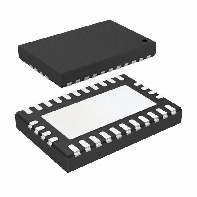

| Серия | LM73606-Q1 |
Синхронный понижающий преобразователь напряжения 3,5 В в 36 В, 6 А
LM73605-Q1/LM73606-Q1 3.5-V to 36-V, 5-A or 6-A Synchronous Step-Down Voltage Converter datasheet

| Parameters / Models | LM73606QRNPRQ1![]() | LM73606QRNPTQ1![]() |
| Control Mode | Current Mode | Current Mode |
| Duty Cycle(Max), % | 96 | 96 |
| Основные особенности | Enable,Forced Pulse Width Modulation (FPWM) Mode,Frequency Synchronization,Light Load Efficiency,Over Current Protection,Power Good,Pre-Bias Start-Up,Synchronous Rectification,UVLO Fixed,Wettable Flanks Package | Enable,Forced Pulse Width Modulation (FPWM) Mode,Frequency Synchronization,Light Load Efficiency,Over Current Protection,Power Good,Pre-Bias Start-Up,Synchronous Rectification,UVLO Fixed,Wettable Flanks Package |
| Iout(Max), A | 6 | 6 |
| Iq(Typ), мА | 0.015 | 0.015 |
| Рабочий диапазон температур, C | от -40 до 125 | от -40 до 125 |
| Package Group | WQFN | WQFN |
| Rating | Automotive | Automotive |
| Regulated Outputs | 1 | 1 |
| Switching Frequency(Max), kHz | 2200 | 2200 |
| Switching Frequency(Min), kHz | 350 | 350 |
| Тип | Converter | Converter |
| Vout(Max), В | 34 | 34 |
| Vout(Min), В | 1 | 1 |
