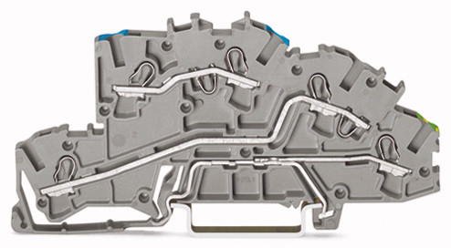

Многоуровневая монтажная клеммная колодка; 4 мм²; N/L/PE; Push-in CAGE CLAMP

Actuation typePush-in Operating tool
Цветgray
Connectable conductor materialsCopper
Connection technologyPush-in CAGE CLAMP®
Country of originDE
Габариты: глубина96 mm / 3.78 inch
Designangled
Fine-stranded conductor0.25 … 4 mm² / 22 … 12 AWG
Fine-stranded conductor with ferrule, push-in termination, from0.75 mm² / 18 AWG
Fire load0.245 MJ
GTIN4044918925617
Height from upper-edge of DIN-35 rail42.3 mm / 1.665 inch
Insulating materialPolyamide 66 (PA 66)
Legend (ratings)(III / 3) ≙ Overvoltage category III / Pollution degree 3
Marking levelCenter/side marking
Nominal cross section2.5 mm²
Number of levels3
Potential markingN/L/PE
Product Group22 (TOPJOB S)
Rated current32 A
Rated current (2)32 A
Rated impulse voltage (III / 3)4 kV
Rated impulse voltage (III / 3) 26 kV
Rated voltage (III / 3)250 В
Rated voltage (III / 3) 2400 В
Ratings notepotential - ground
Ratings note 2potential-potential
Solid conductor0.25 … 4 mm² / 22 … 12 AWG
Solid conductor, push-in termination0.75 … 4 mm² / 18 … 12 AWG
Strip length10 … 12 mm / 0.39 … 0.47 Inch
Total number of connection points5
Total number of potentials3
Type of mountingDIN-35 rail
Type of wiringFront-entry wiring
Вес16.318 г
Ширина5.2 mm / 0.205 inch
