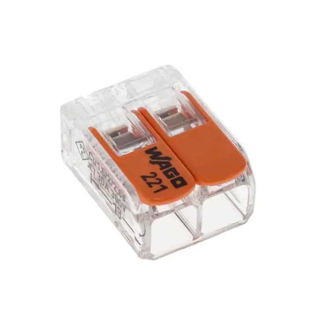

Datasheet Wago 221-612
Соединитель для сращивания COMPACT; 2-проводной; с рычагами управления; 10 AWG; прозрачный корпус

Actuation typeLever
Цветtransparent
Connectable conductor materialsCopper
Connection technologyCAGE CLAMP®
Country of originDE
Габариты: глубина21.1 mm / 0.831 inch
Fine-stranded conductor0.5 … 6 mm² / 20 … 10 AWG
Flammability class per UL94V2
GTIN4055143704168
Height10.1 mm / 0.398 inch
Legend (ratings)(II / 2) ≙ Overvoltage category II / Pollution degree 2
Nominal cross section6 mm²
Packaging typeBOX
Rated current41 A
Rated impulse voltage (II / 2)4 kV
Rated voltage (II / 2)450 В
Solid conductor0.5 … 6 mm² / 20 … 10 AWG
Stranded conductor0.5 … 6 mm² / 20 … 10 AWG
Strip length12 … 14 mm / 0.47 … 0.55 Inch
Surrounding air (operating) temperature85 °C
T-Marking per EN 60998T85
Total number of connection points2
Total number of potentials1
Type of wiringSide-entry wiring
Вес2.55 г
Ширина16 mm / 0.63 inch
