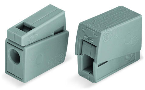

Соединитель для крепления; 1-полюсный (1 одножильный к 1 одножильному, многожильному или тонкожильному); серый

Actuation typePush-in
Цветgray
Connectable conductor materialsCopper
Connection technologyPUSH WIRE®
Connection technology 2CAGE CLAMP®
Connection type (1)Installation side:
Connection type (2)Lighting side:
Country of originCH
Габариты: глубина20.4 mm / 0.803 inch
Fine-stranded conductor (2)0.5 … 2.5 mm² / 20 … 16 AWG
Fire load0.041 MJ
GTIN4044918583817
Height15.5 mm / 0.61 inch
Legend (ratings)(II / 2) ≙ Overvoltage category II / Pollution degree 2
Number of connection points1
Rated current24 A
Rated impulse voltage (II / 2)4 kV
Rated voltage (II / 2)400 В
Solid conductor1 … 2.5 mm² / 14 … 12 AWG
Solid conductor (2)0.5 … 2.5 mm² / 20 … 16 AWG
Strip length9 … 11 mm / 0.35 … 0.43 Inch
Total number of connection points2
Total number of potentials1
Type of wiringSide-entry wiring
Вес2.128 г
Ширина8 mm / 0.315 inch
