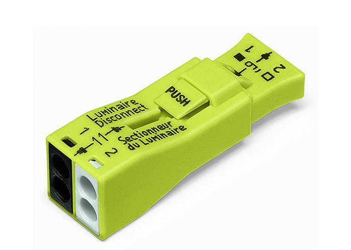

Actuation typePush-in
Цветyellow
Connectable conductor materialsCopper Aluminum
Connection technologyPUSH WIRE®
Country of originCN
Габариты: глубина42 mm / 1.654 inch
Fire load0.103 MJ
GTIN4045454548421
Height13.2 mm / 0.52 inch
Legend (ratings)(II / 2) ≙ Overvoltage category II / Pollution degree 2
Number of Poles2
Product Group8 (Misc. Chassis Mount Blocks)
Ratings according to 2EN 61984
Solid conductor0.75 … 0 mm² / 18 …
Solid conductor (2)male part 0.75 … 4 mm² / 18 … 12 AWGfemale part 0.75 mm² / 18 AWG
Solid conductor (3)0.75 … 4 mm² / 18 … 12 AWG
Stranded conductor1.5 … 4 mm² / 16 … 12 AWG
Strip length11 … 13 mm / 0.43 … 0.51 Inch
Strip length (2)9 … 11 mm / 0.35 … 0.43 Inch
Total number of connection points4
Total number of potentials2
Вес4.763 г
Ширина13 mm / 0.512 inch
