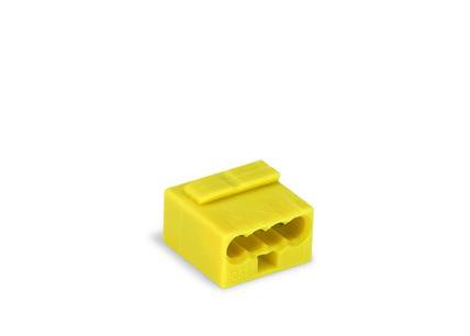

| Actuation type | Push-in |
| Цвет | yellow |
| Conductor diameter | 0.6 … 0.8 mm / … AWG |
| Connectable conductor materials | Copper |
| Connection technology | PUSH WIRE® |
| Country of origin | DE |

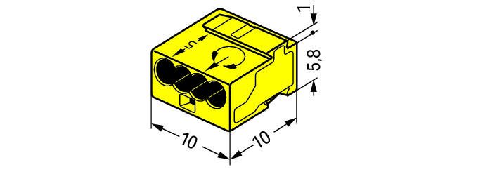

| Габариты: глубина | 10 mm / 0.394 inch |
| Fire load | 0.012 MJ |
| GTIN | 4044918440813 |
| Height | 6.8 mm / 0.268 inch |
| Legend (ratings) | (II / 2) ≙ Overvoltage category II / Pollution degree 2 |
| Number of connection types | 1 |
| Number of levels | 1 |
| Rated current | 6 A |
| Rated impulse voltage (II / 2) | 1.5 kV |
| Rated voltage (II / 2) | 100 В |
| Strip length | 5 … 6 mm / 0.2 … 0.24 Inch |
| Surrounding air (operating) temperature | 60 °C |
| Total number of connection points | 4 |
| Total number of potentials | 1 |
| Type of wiring | Side-entry wiring |
| Вес | 0.76 г |
| Ширина | 10 mm / 0.394 inch |
