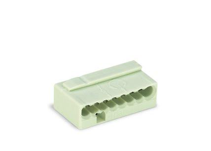

Actuation type | Push-in |
Цвет | light gray |
Conductor diameter | 0.6 … 0.8 mm / … AWG |
Connectable conductor materials | Copper |
Connection technology | PUSH WIRE® |
Country of origin | DE |

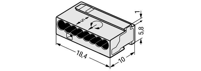

Габариты: глубина | 10 mm / 0.394 inch |
Fire load | 0.019 MJ |
GTIN | 4044918502689 |
Height | 6.8 mm / 0.268 inch |
Legend (ratings) | (II / 2) ≙ Overvoltage category II / Pollution degree 2 |
Number of connection types | 1 |
Number of levels | 1 |
Rated current | 6 A |
Rated impulse voltage (II / 2) | 1.5 kV |
Rated voltage (II / 2) | 100 В |
Strip length | 5 … 6 mm / 0.2 … 0.24 Inch |
Surrounding air (operating) temperature | 60 °C |
Total number of connection points | 8 |
Total number of potentials | 1 |
Type of wiring | Side-entry wiring |
Вес | 1.44 г |
Ширина | 18.4 mm / 0.724 inch |
