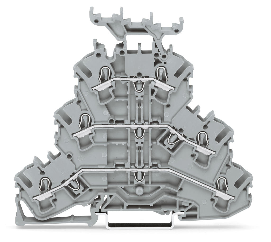

Datasheet Wago 2002-3231 — Даташит
Клеммная колодка TOPJOB S с тремя уровнями; проходная/проходная/проходная (L/L/L); с держателем маркера; монтаж на рейку; 2-проводная; ширина 5,2 мм; серая

Actuation type | Open Tool Slot |
Цвет | gray |
Connectable conductor materials | Copper |
Connection technology | Push-in CAGE CLAMP® |
Country of origin | DE |
Габариты: глубина | 93.3 mm / 3.673 inch |
Design | horizontal |
Fine-stranded conductor | 0.25 … 4 mm² / 22 … 12 AWG |
Fine-stranded conductor with ferrule, push-in termination, from | 0.75 mm² / 18 AWG |
Fire load | 0.336 MJ |
GTIN | 4044918989756 |
Height from upper-edge of DIN-35 rail | 81.3 mm / 3.201 inch |
Marking level | Center/side marking |
Nominal cross section | 2.5 mm² |
Number of connection points | 3 |
Number of connection points (connection type) | 3 |
Number of levels | 3 |
Potential marking | L/L/L |
Product Group | 22 (TOPJOB S) |
Rated current (Ex e II) | 19 A |
Rated current (Ex e II) with jumper | 17 A |
Rated voltage EN (Ex e II) | 440 В |
Solid conductor | 0.25 … 4 mm² / 22 … 12 AWG |
Solid conductor, push-in termination | 0.75 … 4 mm² / 18 … 12 AWG |
Strip length | 10 … 12 mm / 0.39 … 0.47 Inch |
Total number of connection points | 6 |
Total number of potentials | 3 |
Type of mounting | DIN-35 rail |
Type of wiring | Front-entry wiring |
Вес | 17.528 г |
Ширина | 5.2 mm / 0.205 inch |
