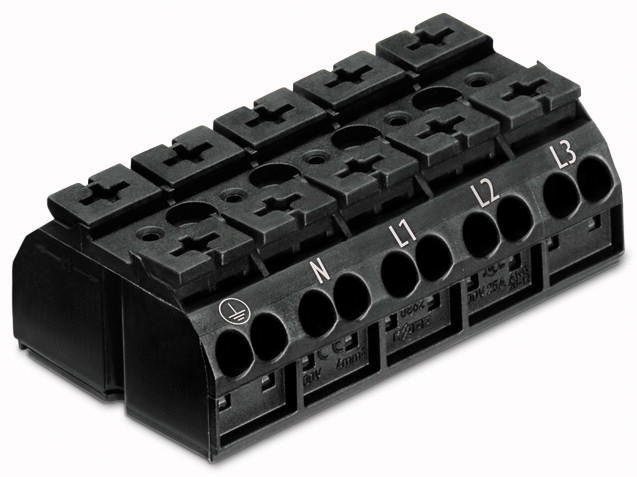

4-проводная клеммная колодка Ex e II для монтажа на шасси; для крепления с помощью винта M3 и гайки или самореза Ø 2,9 мм сверху; PE-N-L1-L2-L3; без заземляющего контакта; подходит для применений Ex e II; 5-полюсная
4-CONDUCTOR CHASSIS-MOUNT TERMIN | |||
862-1505/999-950 Wago | по запросу |
Actuation type | Operating tool |
Цвет | black |
Connectable conductor materials | Copper |
Connection technology | Push-in CAGE CLAMP® |
Country of origin | DE |
Габариты: глубина | 35 mm / 1.378 inch |
Fine-stranded conductor | 0.5 … 4 mm² / 20 … 12 AWG |
Fine-stranded conductor with ferrule with plastic collar | 0.5 … 2.5 mm² / 20 … 12 AWG |
Fine-stranded conductor with ferrule, push-in termination, from | 0.75 mm² / 18 AWG |
Fire load | 0.641 MJ |
GTIN | 4045454789213 |
Height from the surface | 22.3 mm / 0.878 inch |
Marking | PE-N-L1-L2-L3 |
Mounting type | Screw mounting |
Number of Poles | 5 |
Packaging type | bag |
Pin spacing | 12 mm / 0.472 inch |
Rated voltage EN (Ex e II) | 440 В |
Solid conductor | 0.5 … 4 mm² / 20 … 12 AWG |
Solid conductor, push-in termination | 0.75 … 4 mm² / 18 … 12 AWG |
Stranded conductor | 0.5 … 4 mm² / 20 … 12 AWG |
Strip length | 10 … 11 mm / 0.39 … 0.43 Inch |
Total number of connection points | 20 |
Total number of potentials | 5 |
Type of mounting | Chassis-mount |
Type of wiring | Side-entry wiring |
Вес | 34.094 г |
Ширина | 60 mm / 2.362 inch |
