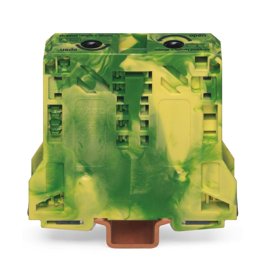

2-проводная клеммная колодка заземления; 50 мм²; боковые пазы для маркеров; только для рейки DIN 35 x 15; толщина 2,3 мм; медь; POWER CAGE CLAMP

Actuation type | Operating tool |
Цвет | green-yellow |
Connectable conductor materials | Copper |
Connection technology | POWER CAGE CLAMP |
Country of origin | PL |
Габариты: глубина | 94 mm / 3.701 inch |
Design | horizontal |
Fine-stranded conductor | 10 … 70 mm² / 8 … 2/0 AWG |
Fire load | 1.98 MJ |
GTIN | 4045454507435 |
Height from upper-edge of DIN-35 rail | 87 mm / 3.425 inch |
Marking level | Side marking |
Number of levels | 1 |
Product Group | 1 (Rail Mounted Terminal Blocks) |
Solid conductor | 10 … 50 mm² / 8 … 1/0 AWG |
Strip length | 30 mm / 1.18 Inch |
Total number of connection points | 2 |
Total number of potentials | 1 |
Type of mounting | DIN-35 rail |
Type of wiring | Side-entry wiring |
Вес | 186.522 г |
Ширина | 20 mm / 0.787 inch |
