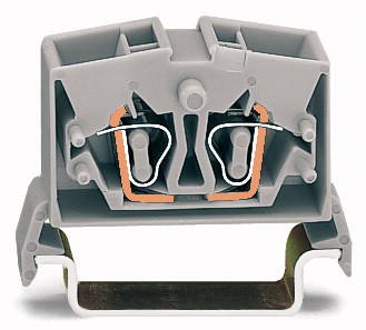

Datasheet Wago 264-731 — Даташит
4-проводная миниатюрная проходная клеммная колодка; 2,5 мм²; с возможностью тестирования; маркировка центра; для DIN-рейки 35 x 15 и 35 x 7,5; CAGE CLAMP

Actuation type | Operating tool |
Цвет | gray |
Connectable conductor materials | Copper |
Connection technology | CAGE CLAMP® |
Country of origin | CH |
Габариты: глубина | 38 mm / 1.496 inch |
Design | horizontal |
Fine-stranded conductor | 0.08 … 2.5 mm² / 28 … 12 AWG |
Fire load | 0.106 MJ |
GTIN | 4044918414913 |
Height from upper-edge of DIN-35 rail | 24.5 mm / 0.965 inch |
Legend (ratings) | (III / 3) ≙ Overvoltage category III / Pollution degree 3 |
Marking level | Center marking |
Number of levels | 1 |
Product Group | 9 (Std. Chassis Mt. Blocks) |
Rated current | 24 A |
Rated impulse voltage (III / 3) | 8 kV |
Rated voltage (III / 3) | 800 В |
Solid conductor | 0.08 … 2.5 mm² / 28 … 12 AWG |
Strip length | 8 … 9 mm / 0.31 … 0.35 Inch |
Total number of connection points | 4 |
Total number of potentials | 1 |
Type of mounting | DIN-35 rail |
Type of wiring | Front-entry wiring |
Вес | 6.156 г |
Ширина | 10 mm / 0.394 inch |
