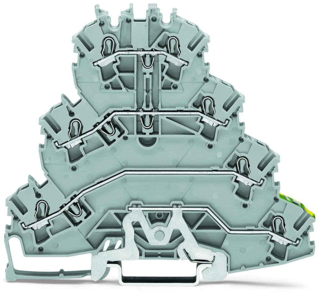

Четырехуровневая клеммная колодка TOPJOB S; заземление/сквозь/сквозь/сквозь (PE/L3/L2/L1); монтаж на рейку; 2-проводная; ширина 5,2 мм; серая

| Actuation type | Open Tool Slot |
| Цвет | gray |
| Connectable conductor materials | Copper |
| Connection technology | Push-in CAGE CLAMP® |
| Country of origin | CN |
| Габариты: глубина | 103.5 mm / 4.075 inch |
| Fine-stranded conductor | 0.25 … 4 mm² / 22 … 12 AWG |
| Fine-stranded conductor with ferrule, push-in termination, from | 0.75 mm² / 18 AWG |
| Fire load | 0.389 MJ |
| GTIN | 4050821579410 |
| Height from upper-edge of DIN-35 rail | 83.9 mm / 3.303 inch |
| Insulating material | Polyamide 66 (PA 66) |
| Legend (ratings) | (III / 3) ≙ Overvoltage category III / Pollution degree 3 |
| Nominal cross section | 2.5 mm² |
| Number of connection points | 1 |
| Number of connection points (connection type) | 2 |
| Number of levels | 4 |
| Potential marking | L1 - L2 - L3 - PE |
| Product Group | 22 (TOPJOB S) |
| Rated current | 20 A |
| Rated current (2) | 25 A |
| Rated impulse voltage (III / 3) | 8 kV |
| Rated voltage (III / 3) | 800 В |
| Solid conductor | 0.25 … 4 mm² / 22 … 12 AWG |
| Solid conductor, push-in termination | 0.75 … 4 mm² / 18 … 12 AWG |
| Strip length | 10 … 12 mm / 0.39 … 0.47 Inch |
| Total number of connection points | 7 |
| Total number of potentials | 4 |
| Type of mounting | DIN-35 rail |
| Type of wiring | Front-entry wiring |
| Вес | 25.282 г |
| Ширина | 5.2 mm / 0.205 inch |
