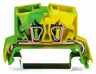

4-проводная мини-клеммная колодка для монтажа на рейку; 2,5 мм²; маркировка центра; для DIN-рейки 35 x 15 и 35 x 7,5; CAGE CLAMP

| Actuation type | Operating tool |
| Цвет | green-yellow |
| Connectable conductor materials | Copper |
| Connection technology | CAGE CLAMP® |
| Country of origin | DE |
| Габариты: глубина | 46.5 mm / 1.831 inch |
| Design | horizontal |
| Fine-stranded conductor | 0.08 … 2.5 mm² / 28 … 12 AWG |
| Fire load | 0.118 MJ |
| GTIN | 4044918451956 |
| Height from upper-edge of DIN-35 rail | 24.5 mm / 0.965 inch |
| Marking level | Center marking |
| Number of levels | 1 |
| Product Group | 9 (Std. Chassis Mt. Blocks) |
| Solid conductor | 0.08 … 2.5 mm² / 28 … 12 AWG |
| Strip length | 8 … 9 mm / 0.31 … 0.35 Inch |
| Total number of connection points | 4 |
| Total number of potentials | 1 |
| Type of mounting | DIN-35 rail |
| Type of wiring | Front-entry wiring |
| Вес | 8.86 г |
| Ширина | 10 mm / 0.394 inch |
